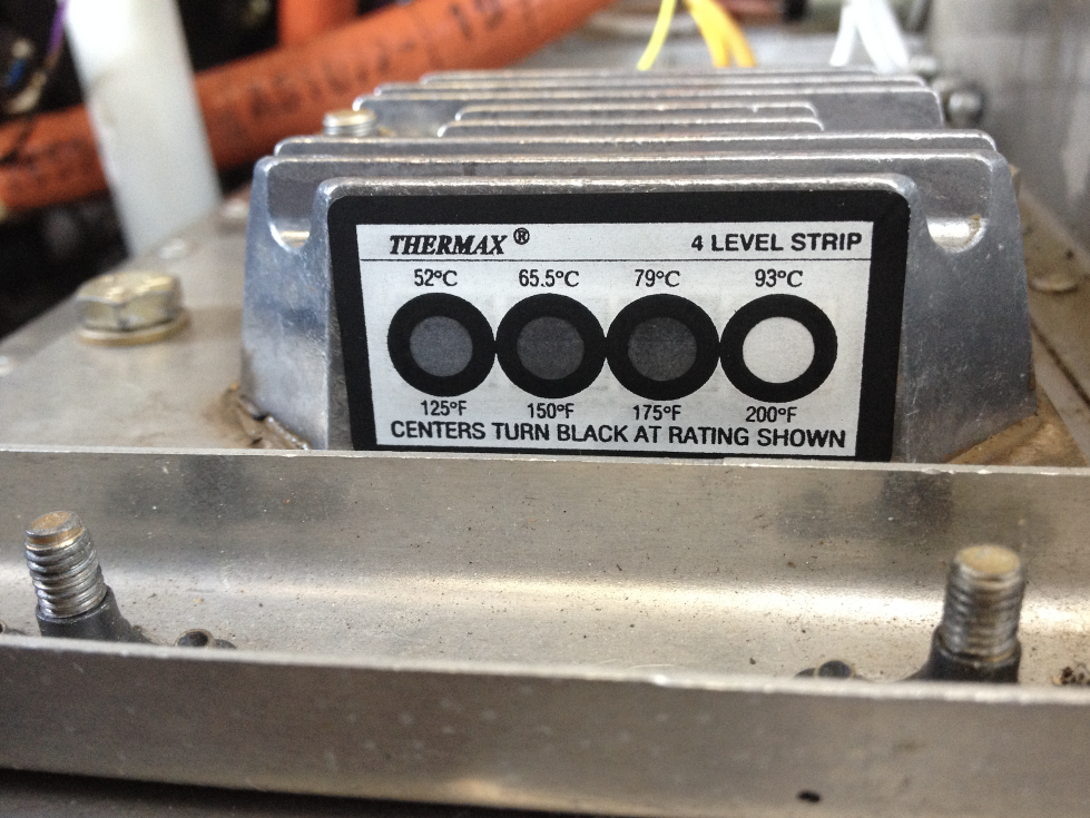

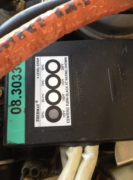

I know I will anger the thunder gods and end up with a VR failure to say this, but my first VR lasted almost 500 hours and the second one has almost that much time on it now in spite of Phoenix summers. I put temperature witness tape on my VR and ignition modules, and 170F seems to be the max temp seen. Kinda scary!
Thermal tape showing John Deere VR saw at least 175F. Could have been over 175F but not close enough to 200F to mark the tape. No problems.
I also ?taped? the ignition module and it runs considerably cooler?

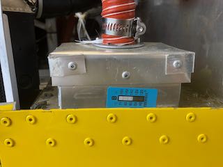

I installed a SH VR in the engine area. I moved it to the left of its original location so it would not be in the slipstream of the radiator. I have a blast tube on it that gets the air from the air duct that supplies air for the radiator. The temperature for the last several oil changes has been about 135 F. Here is a picture showing the thermal strip.

I noticed the green label on your ignition module. Isn?t that the older version without soft start? I thought the new ones have yellow labels, or have have I got that backwards?
