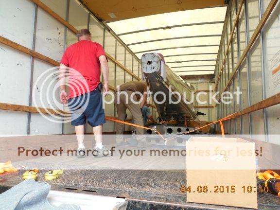

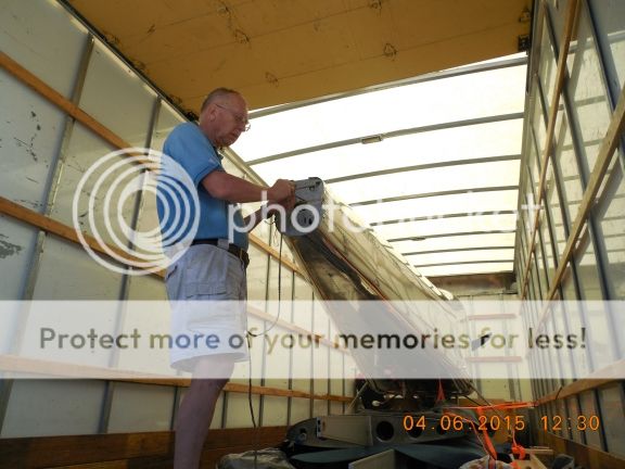

That's how I got mine from home (where I built it) to the airport but I only had to travel about 25 miles. I think you'd be OK but you'd probably want to secure things more than I had to for a short trip.
I don't have any real good pictures but these show a bit of how it worked.

Wow, just what I needed, thanks a lot. I cannot see clearly,
but did you have to put blocks under the mains in order for them to fit?Anybody else with even more detailed photos would be appreciated..

Nope, no blocks necessary other than wheel chocks that I screwed to the floor of the truck. The wings fit nicely under the fuse and even cleared the comm antenna. Worked out pretty well.
Notice that I did not have the tail mounted, though. The friends helping me took those in their pickup. I used the 26' (?) Penske truck and had plenty of room, even considering that I was also carrying one of my workbenches along with my -12. I don't think there'd be a problem space-wise. Securing everything so nothing vibrates against anything else will be the challenge. You'll need plenty of moving pads, tie-down straps and ropes.

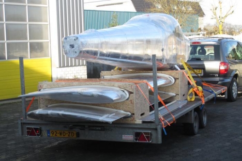

My plane coming back from paint - with padding overlapped but side by side underneath
I help haul Marks's aka - skunkworks RV12 on a different trailer. The wings were stacked on top of each other
