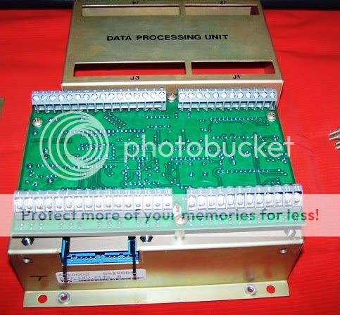

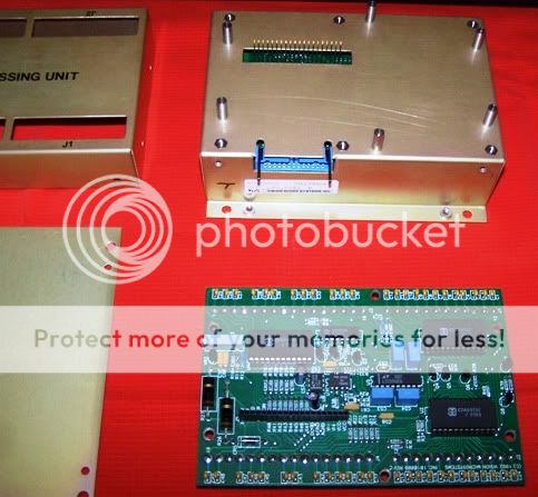

The DPU is the system brain, a very robust & elegantly simple computer with two major components, the analog & digital PC boards. The analog board has the terminal blocks (see pics 1 & 2), accepts inputs from all sensors/transducers, converts the signals as needed for processing, & routes them to the digital board by a set of connecting pins in the middle of the DPU case. The early generation DPUs had these connector pins hard soldered between the 2 boards making them very difficult to dismantle for repair. VMS later went to a header pin & connector setup which allowed the main PC boards to be easily separated. The analog board has 3 signal busses each with its own processing chip: one for the EGT signals (terminal J1), one for the CHT (J2), & one that handles all the other engine data signals from terminals J3/J4. When it comes to physical abuse, the poor analog board takes the brunt of any punishment you or the aircraft dish out to it ? more on this later.
Pic 1 - DPU with Analog Board Cover removed.
Pic 2 - Analog Board removed from DPU.

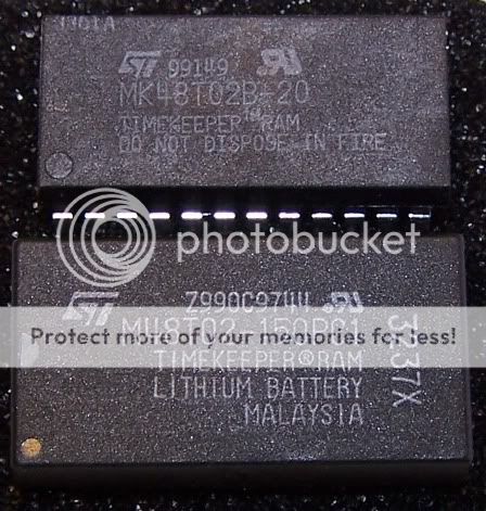

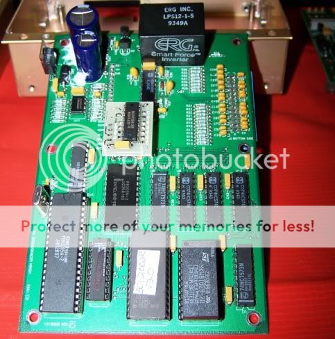

The second main component of the DPU is the digital board (see pic 3). The digital board accepts data from the analog board, analyzes it, & generates the appropriate signals to drive the cockpit indicators/warning annunciations. These signals output through the 26 pin rectangle connector to the ribbon cable assembly & the indicators. The digital board additionally houses the backlight subsystem which was covered in some detail in a previous article. Also mounted on the digital board is an integrated circuit (IC) chip affectionately known as the ?battery chip,? in reality is a multifunction IC consisting of the DPU?s memory, clock/timekeeper, plus a ?keep alive? lithium battery. Early generation battery ICs had limited service life due to an undersized lithium cell, sometimes lasting only 3 years before needing replacement; later an upgraded version addressed this. These early MK48T02B-20 chips are noticeably smaller than the subsequent replacement, M48T02-200PC1 (see pic 4). The -200 chips were an improvement over previous versions & had better service life on the order of 6-8 years, production ended on these some time ago. The current production chips p/n M48T02-70PC1 & -150PC1 feature lithium cells with a 10 year minimum life specification; owners have been getting good ?real world? service life out of these chips. Both are compatible with the VMS DPU processor.
Picture #3 - Digital Board removed from DPU.
Picture #4 - Comparison of early chip (top) vs. modern battery IC (bottom)
So when does the battery need to be replaced? If you have a -70 or -150 battery IC, I recommend replacement at 10 years time in service even if it?s working fine ? you don?t want it to fail on you at the most inopportune moment. If you have a -200 ? just replace it now. Your DPU will give you hints that the battery is getting weak & reaching the end of it?s service life. On VM1000s, the initial indications are usually problems with ?lean find mode? being intermittent or not working at all & the fuel computer not accepting additional fuel & ?forgetting? the fuel tank size. On EPI-800s, the fuel computer symptoms are the same as above plus the DPU will lose the local time setting & your peak EGT function may not work. The final death throw with both systems is when the tach time is no longer retained, this indicates the battery is completely failed.
One other note regarding batteries ? I had a case of an owner who could not get his fuel computer to work on a VM1000, it would not accept a fuel tank size nor additional fuel. The owner had just paid $200 to have the battery chip replaced by his local avionics shop & he had successfully reset the tach time so he was sure the problem was in the DPU somewhere ? the avionics shop did not have expertise in VMS units so they contacted me. When I received the DPU & opened it up, it had a -200 battery chip in it ? I guessed the chip was at least 10 years old, a phone call confirmed it was stock that had been on the avionics shop shelf for a long, long time. I replaced the chip with a new production -70, ran a bench test & everything worked perfectly again.
