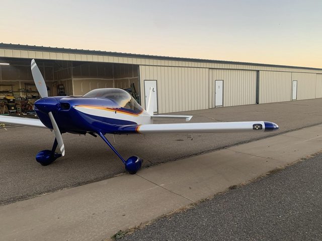

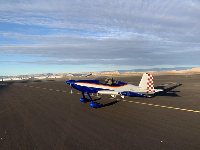

I vinyl wrapped my -14 a few months ago. I had zero experience. I had trouble getting a shop to commit to the job on the days I wanted to get it done. I used both 3m 1080 and 3M 2080 because some of the colors I wanted to use (cosmic blue) were not yet available in the 2080.
The 2080 really is superior, I wish I could have used it for all of my colors. It has a removal clear film which allow you to be much harder on the vinyl during install. In the end this is labor project. The skill and experience of the installer will determine the quality moreso than the vinyl choice itself. Especially around difficult curves like wheelpants, spinners and air intakes. Yes I wrapped every part!
I used 3m edge sealer on all of my edges. There are places where flaws exist if examined. A good paint job is always going to look a bit more flawless than a good vinyl wrap. One does get the advantage of a finish (gloss white gold sparkle in my case) that would be extremely difficult to put on an airplane at a reasonable weight with paint.
The layout and design work is pretty straight forward using knifeless tape. Pinstriping abilities are the only limitation!
The rolls can be bought in 25 yard lengths for a little over $600. I ended up using 1 blue roll, 2 white rolls and smaller quantities of the other colors for a cost somewhere around 2k. I have a ton left over and made a bunch of mistakes as I was learning. 2 rolls might do an entire plane.
I know now how to wrap an airplane or car but I am not entirely sure its a skill I wanted to learn. Its a little bit like putting a screen protector on the phone over and over again. I am excited by the cost and appearance and will definitely wrap any future builds! I would strongly consider hiring a pro to do the actual vinyl application in the future. I would be better served I think to be the mechanic, taking the airplane apart and reassembling, while also serving as an assistant on larger pieces of vinyl. With just one person the process is long and tedious, I estimate about 40-50 hours of labor for me, a beginner. A pro will know how to approach the difficult parts and tricks for smooth and quick application that I learned by frustration.
