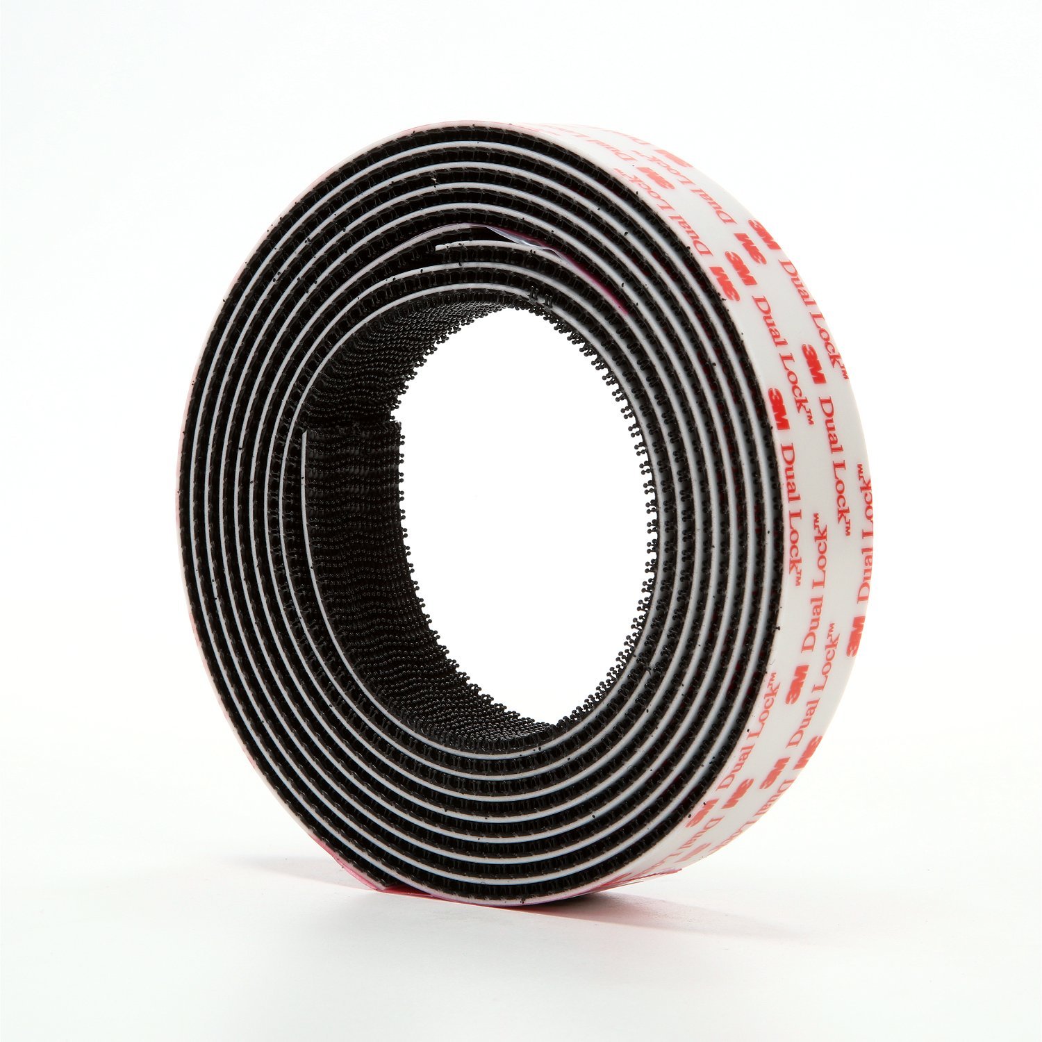

3M dual lock
I've had good success with this. 200F service temp. it is stiff however.
