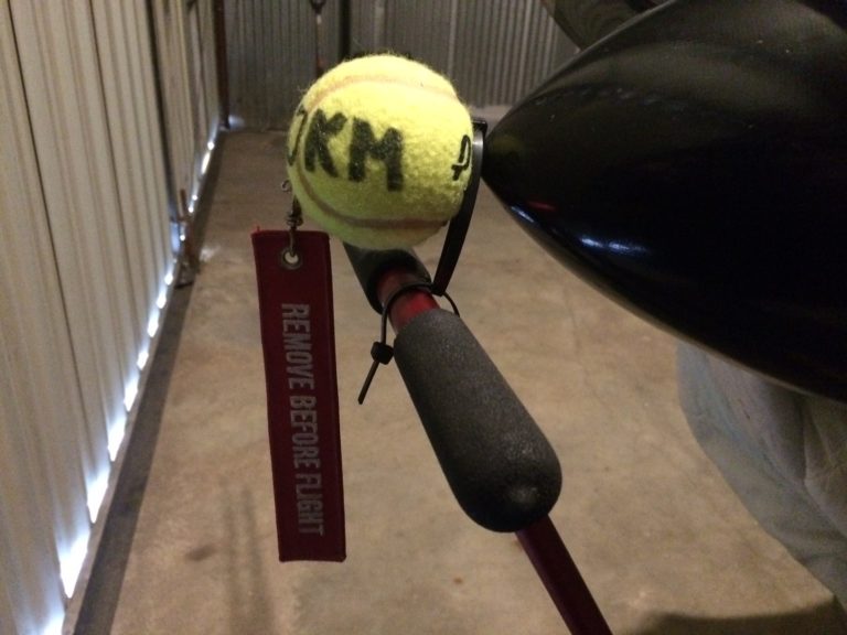

The spinner pitot was chosen as a way to avoid the potential failure mode of an interconnect in the pitot line for the removable wings.
Plus it lets you do this:
Keeps your pitot (and shirt sleeves) protected, and your tow bar handle off the floor.
"Almost" Easy Peezy

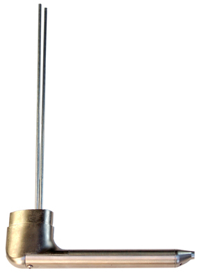

I intend to build in a boom mount Dynon pitot/AoA: through the spinner.
(http://www.dynonavionics.com/aoa-pitot-probes.php)
It saves the hassle of connecting and reconnecting the wings (I'll dismantle the RV after every flight), and saves the risk of leaks.
Since the boom isn't underneath 'a large area such as the wing' the angle of incoming air is to be expected more 'clean'.
What does VAF think of this possibility, please?
Well, since it was a post of mine that you quoted, I will offer that I think you would be adding a lot of work complexity and expense for zero benefit.
