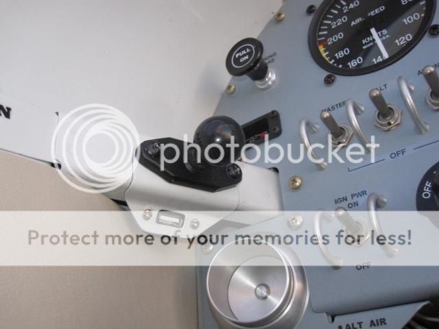

Where have people located these outlets? I thought between the seats on my 9 but then the usb lead would be straight up and liable to be bumped. On the panel but then you have a lead or leads around the cockpit. Would like to know if anyone has located one on the panel and if it is a problem in flight.
I have the traditional round ports on the far left and right side of the panel. I use the one on the left side for my Ipad with a USB adapter at the port. A very short (12 inch) cord goes to the Ipad so there is no dangling cords. I would not put them in the center of the panel nor between the seats.
The side of the port is barely visible in the attached photo behind the Ipad above the air vent. The power cord is not plugged into the bottom of the Ipad in this picture.
BTW my headset ports are located behind the seats and work good there and accessible inflight if needed.
Bevan
Don't put them facing up, wherever you put them. Debris will fall into them and is a pain to clean out. :mad:
Put it/them on the panel somewhere, and not between the seats. Besides the aileron trim, the area between the seats ends up holding all kinds of misc. stuff. You'll find a million uses for that space w/o having a power or USB port there.
I have mine on the panel, passenger side. If I could redo, I'd probably put them farther to the side of the panel so they aren't directly in front of the passenger, but I still haven't had any issues.
Also, you can buy 90 degree USB adapters that can help keep cables from getting bumped. I have a USB connection from my efis on the panel, and use the adapter to keep a thumb drive plugged into it for logging, but easily accessible, and it sits flush against the panel.

I put mine under the panel. You cant see them, but they are easy to find and plug into by feel. There are three reasons I put them here:
1: It was easy and out of sight. A good looking USB port is very expensive.
2: I expect USB to be replaced with something else in the near future, so don't want a permanent panel location for a outdated plug type.
3: A cord coming out of the panel is in the way and subject to potential shear loading from several sources.
I had one under the panel and found it hard to get the cable plugged in and out. I end up buying a better brand and mounting it on the panel. Although I wanted to reserve any space on the panel for feature use, so far seems to be a good decision.

I have a USB and 12 socket on the right side of the panel. Meanwhile I have RAM mounts on both sides and needed a USB plug on the left side also. I installed one below the RAM mount, no extra holes drilled and saving panel space.
