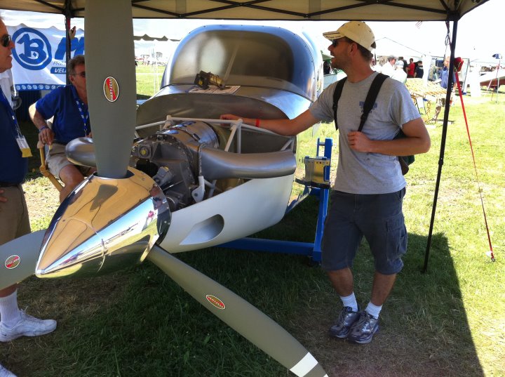

This is a pic of RV-10 turbine project at OSH '11. These guys said their main motivation is the realibility and fuel avilability. Not practical for most of us but pretty cool looking.

I would not have a turbine in my 10. Like the above poster mentioned it would be speed limited. To fly into the FL's safely you would have to have eng inlet/prop/wing deicing and 100-120 gal fuel. You may not have to overhaul the complete engine often, but try $25,000-100,000 for hot section repair. You want to work on it yourself, get some big money ready for all of those special tools. Fuel burn during climb 30-35 gph and cruise 20-25 gph depending on alt/temp. You might save on engine weight but your fuel/deicing equip/engine mount weights will more than make up for it. Unless you run it at higher rpms, airspeeds and FL altitudes your going to pay even more in fuel burn. If I had the money for a turbine I would first pick a faster, properly equipped airframe to stick it in or better yet just buy a proven certified. You think our fatality rate is high now, start putting turbines in RV's. The statistics won't sound so cool.

Too many modifications needed to make an RV-10 practical for a turbine
at least the kind of turbines currently available.
There is already at least one -10 with full length leading edge fuel tanks.
Turbine Solutions already, apparently, have a motor mount and cowl.
Plenty of room for O2.....aaaah, now I see the word 'practical':)

At OSH-12, I saw a new turbine from Dimech Turbine Solution turbine from Deland, FL, also mentioned earlier in this thread (from OSH-11). The turbine company owner is building the RV-10. As usual, lots of "details" remain to be worked out. From looking at the picture from OSH-11, it doesn't look like much has changed in the last year on it.
I believe he said this engine is some 275 pounds lighter than an IO540. He moved the batteries up front, but he said the additional fuel a turbine requires is near the CG, so I never did get a good answer on how he plans to balance the rest of the much lighter front end weight. I hope he has better luck than the Innodyn.
A picture of it:
FWIW to everyone, and to possibly help to clear the air a little, if anyone is interested.
I'm the guy that actually sold my RV10 to Chris, and we still visit occasionally.
His goal is to cater to the European market, as avgas is nearly impossible to find. If it is available, it's too expensive for most folks to afford.
Now, the engine he's using is actually only rated at 240hp. He's NOT looking for more speed or power. The reason it looks as if not much has changed is that during the R&D, if you will, the mount was built and cowling made & fitted. Then they realized the engine turns the opposite direction than the other turbines he's worked with. So, now he had to start over with a new engine mount & cowl. The entire leading edge of the wing is fuel tank (120 gals), sans John Nys of Tulsa, OK.
As far as W&B, that's part of the R&D process, and I'm confident he'll get it right.
Again, not looking for more speed or power, just more market.
