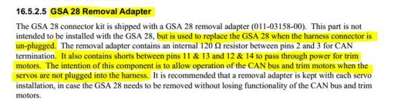

If your trim is connected through a GSA 28, you don't want to use any kind of PWM signal - see your G3X installation manual for the details.
I've gone through the G3X autopilot configuration, though I don't fully understand how it uses both the pitch servo and trim motor to control pitch. So far that hasn't provided any trim function. I've only pulled the 9-pin D-sub from the power module (it checks out okay), and haven't pulled the 50-pin plug, as I don't understand what I'd be testing there, or how.
If you have G3X but no autopilot, you need a jumper plug in place of the Garmin pitch servo to enable manual pitch commands to reach to trim servo.
I've gone through the configuration instructions in Ch 35 of the G3X Installation Manual, at least as far as they can be done on the ground. That includes some settings for the autopilot. I've also tried the blue potentiometer knob in different positions (extreme left & right, middle). The trim does run through the autopilot pitch servo, which confuses me.
In talking today with Tony Kirk at Van's, who drew some of the wiring diagrams for the RV-12 (and is building one, too), he recommended making a couple of test jumpers with D-sub pin ends (one M, one F) and testing continuity with a multimeter, at pin locations for trim functions on the 50-pin D-sub that mounts onto the power module. These would include pins #10 and 50 (to the trim motor) as well as those coming from the control sticks. This would be to make sure the pins are in the correct locations. So I've got some pins on order to try that.
I would disconnect the 9-pin trim connector from the AV6000, substitute a 9-pin plug with wires attached to pins 1 and 2, and test whether pressing each of the trim buttons gives you 12V between those wires.
Also be aware with the G3X installation with autopilot, you must have the Pitch Servo wire harness connector attached to the GSA 28 or have the Garmin Servo Removal Adapter connected to the wire harness connector so the trim servo power will pass through.

You should also check to make sure that pins 1 and 2 (Garmin and Dynon without an AP module) are populated on the 9 pin connector on the back of the AV 60000. If you have. Dynon system with the AP module check to make sure pins 6 and 9 are in the correct place.
