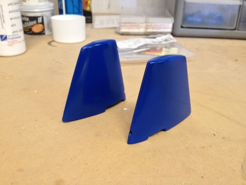

With the addition of my ADSB antenna, I decided to dust off my fiberglass skills and clean up romeo yankee's belly. I bought the cheap antennas so it started looking like a forest under there. I highly doubt that any performance gains were made, but I had fun.

Very nice! Can you please provide some detail on how these are attached? Do they attach to the aircraft or to the antenna, or both?

yes, those are the antennas. I used pink insulation foam to make the shape, and incorporated a nylon block at the base. I put a set screw in the block that tightens to the nylon insulator on the antenna, just enough to hold it steady. Although the purists will disagree, there was no change in the performance of the antenna; At least not in my empirical testing.
just a bit of foam, shape as you wish, a nylon block at the base with an allen set screw, one layer of fiberglass. I left the foam in there, it was really light already.

Hi Don...we talked about this before, which is why I have not mixed up some micro and cast a airfoil shape around my rod'nball antenna.
Curiosity question; it sounds like the dielectric described above is in physical contact with the antenna mast. Does theory predict a different result if the airfoil fairing is a thin glass/epoxy shell, not in contact with any part of the antenna?
To answer questions I fabricated a foam shape similar to what I believe Robert displayed in the first post to test the effects on antenna performance.
The test consisted of a TED monopole transponder antenna mounted on a 8? dia ground plane and 1? thick blue "Home Depot" type foam. The foam shape did not touch the antenna element.

The antenna resonate frequency was pulled down but the VSWR was still within reasonable limits. Based on what I tested I would not be hesitant to attach this antenna system to my transponder.
Suggestions:
Minimize material on the exterior of the foam shape, construct a thin FG layup to form the hard shell.
Do not use the antenna element to attach the foam shape, the results improved when the foam did not touch the element.

I hadn't looked at this thread for a while, thanks for the testing. My fairings sound like just as you describe. I hollowed out the foam after laying up the shell. Minimum weight and not touching the antenna. Unfortunately this makes the fairing cross section a little thicker than if it touched the antenna, but not by too much. I have noticed no reduction in reception with my ADSB antenna. Quite honestly I did this for the fun of it, but hopefully it makes the plane go faster too!
