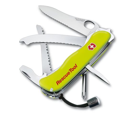

FWIW, I carry a pair of leather work gloves and a multi-tool (with sharp point, saw, and pliers) in my RV-12's glove box. I figure that I can more effectively deal with recalcitrant plexiglass shards if wearing gloves.

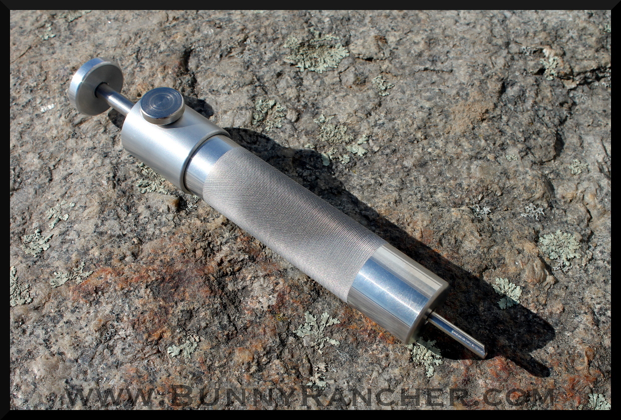

penetrating bolt gun https://www.bunnyrancher.com/store/p42/The_Ballista_-_Penetrating_Bolt_Gun_.html

Also, a few years ago at Sun n Fun there was a vender demonstration where a guy used a Wave multitool to break a canopy with the pliers function. It has a particularly pointed tip.
