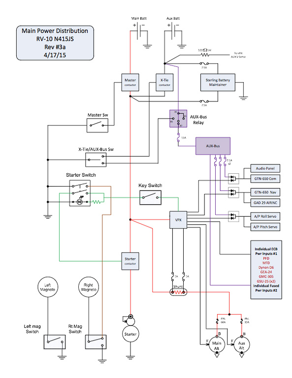

One of the hats I wear is that of a home automation specialist. In home automation we still use individual resettable breakers, but in many respects the Vertical Power VP-X resembles a home automation controller. “Switches” installed do not actually switch anything at all, they simple change the state of a yes/no function withing the VP-X, and it exececutes whatever switching tasks it has been programmed to perform in response. This can be very powerful. (In my home a keypad button by my bedside has programmed as a “good night” button, which dutifully turns off any lights left on on all five buildings on my property, brings up a seasonally appropriate set of outdoor lighting, arms the security system, and closes all blinds. Doing all that with conventional switches would be impossible.)
The VP-X also provides a good deal of information about the health of the electrical system, and it eliminates a plethora of potential failure points associated with all the crimp connectors and load-carrying switches it eliminates, so the thought of installing one with my upcoming all-Garmin panel upgrade is pretty suductive.
Yet somehow, I’m having trouble pulling the trigger. My panel is being designed with redundancy and failure tolerance in IFR scenarios as a high priority, and there are aspects of the VP-X that may be contrary to this goal. First, access to and control of the VP-X requires a functioning EFIS, a G3X Touch in my case. While it is true that even with an EFIS failure, the Vp-X should continue doing its job after an EFIS failure, the thought of this is a bit unsettling. If the failure involves other components, how can you investigate? Another concern is that the VP-X is software/firmware dependent, and a problem there could bring down the whole shooting match without recourse. That is why I use software-free lightspeed ignitions instead ofthe other choices. Although the VP-X would eliminate a large number of failure points, few if any of those would be very disabling by themselves. These concerns make the already-installed switches and breakers in my panel look a lot more attractive.
So, even though my home-automation experience draws me toward the VP-X, I find myself leaning the other way at the moment. Any insights or opinions out there would be much appreciated, and would surely help with the final decision.- Otis

That sounds great. I'm also planning a VPX.
I'm sure others besides myself would like to see your wiring diagram.

Here's mine - for discussion/entertainment only, not to be interpreted by anyone, especially lawyers, as instructions on how to build anything...

I offer that once you decide on a more robust two battery, two independent avionics buss IFR design builders should take precaution to not have the situation where this one box failing yields a dark panel. I?ve seen the work around to do this and keep the VPX box. At that point however other options open up that may be more attractive to some builders.
In other words, new builders should look at the product as one of many ways to achieve their design objectives.

Yep - this $2k+ box does all that. In short, for a single battery VFR airplane it is an interesting, if not expensive alternative.
I offer that once you decide on a more robust two battery, two independent avionics buss IFR design builders should take precaution to not have the situation where this one box failing yields a dark panel. I’ve seen the work around to do this and keep the VPX box. At that point however other options open up that may be more attractive to some builders.
Carl
Hmmm, That's funny. I run two batteries with a VPX-Pro and I don't have a problem with my EFIS system or ignitions going out if I lose the VPX. And again, going on 5 years without a glitch on the VPX-Pro. Wish I could say the same for all the other products I / I've used. With all due respect, it's pretty unfair for anyone to give pros and cons on a product they have never used. Opinions in installations is fair game.
