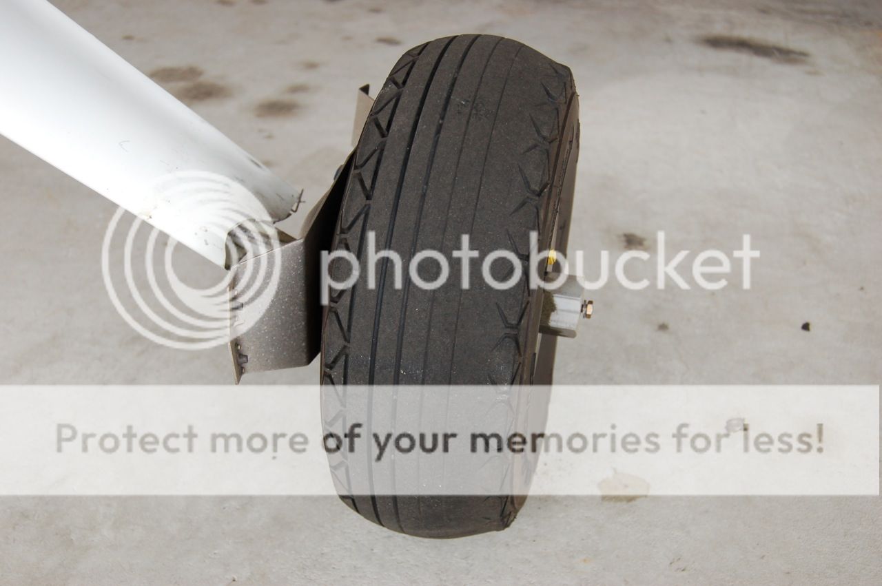

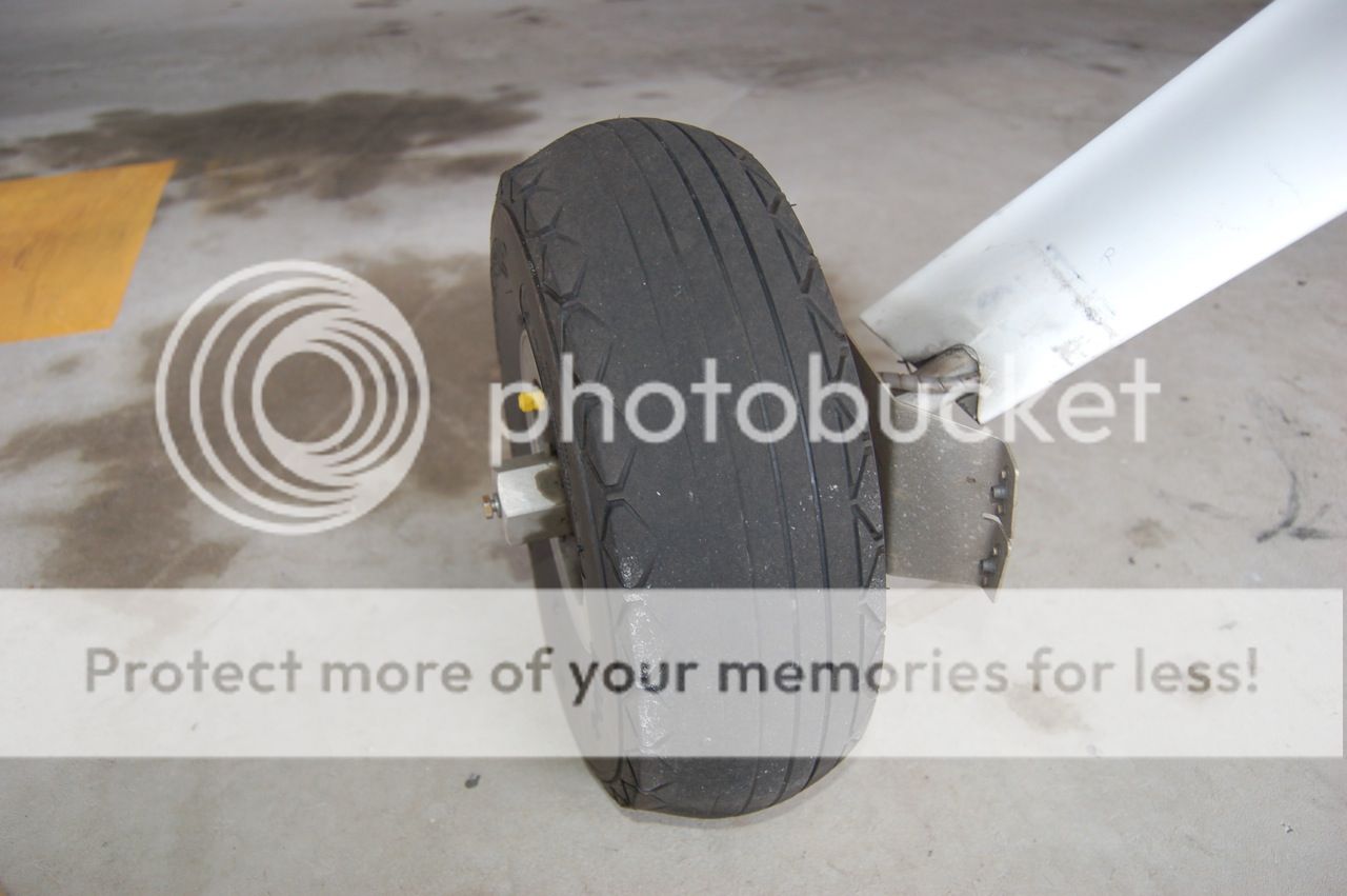

I remember a thread about tire wear but can't find it. Doing a condition inspection and tires are worn on the outside. Is this normal or is the tire tracking wrong?
Tire (and brake) wear...
At 112 hours my main tires are showing considerable wear on the outside and I think this is normal from what others have posted. At the next annual in May, I plan to reverse the tires.
Also showing considerable wear are the brake pads which are getting close to the limit of the wear notch. I ordered the Matco "Swiftline Kit" which is new pads installed on new shoes. I don't have a riveting tool for those kind of rivets. After you install the new brakes, you can then send your old shoes to Matco and they will reline them for no installation charge and with a discount on new pads. So you only pay the pad riveting charge one time. Seems like a lot better idea than trying to rivet the pads on yourself, especially if you don't have the tools or know-how. I know, I know, you guys out in Iowa probably do this on tractors and stuff all the time ;).
Tony
This is normal for spring-type gear like the RV-12.
What's happening is that the unloaded tire contacts the ground on landing closer to the outside of the tread. Then as the landing gear picks up load, it deflects and the middle of the tread, or more inboard, tends to have contact.
Dave

We've got 220 hours on the RV-8 now with more landings than I can count. Both main tires still have plenty of tread left, but curiously the most visible wear is on the inside of the left main. The right main is wearing evenly.
Does the wheel camber look correct? Normally the tires will wear on the outside a bit more than the inside. The reason I ask is that during a recent condition inspection on an 8A I noticed the tires were cambered in like the aircraft had a hard landing. Turns out the gear was from a 9A that was installed on an 8A due to a shipping error from vans (about 10 years ago). Van's advised everyone involved but apparently this builder never got the note!

Count landings not hours. I used Aero Classics for years on two of my RV6's and really liked them. I changed to Michelins one time and they worked well except for the price. My present set is Monster retreads from Desser and so far, so good. Outside wear is perfectly normal on RV's. I found one tip that helps keep more of the wear to the center of the tire. That is to run with max tire pressures. (40-45 lbs). On some planes this will cause gear leg ocsilliation, which will seem like a vibration, at some taxi speeds. Then it will be time to order some gearleg stiffeners.

We got about 40 hours on our first set. The issue was not the tires and both myself and plane partner are experienced CFIs so we do not land fast or land with side loads, or ride brakes. The problem was excessive toe-in. On the nose staggers you have no adjustment for the axle except the hole in the weldment and gear strut. These are both predrilled and the builder only reams them to the final diameter. We did extensive tests to measure our toe-in and it was 3.5 degrees. The correct range is 0 to 0.5. Did not want to take the weldments out as this would be HUGE. Contacted Van's and they arranged to have the gear leg plugged and re-drilled The problem was an issue with the weldment. About five years or so ago some weldments may have been misdrilled and since they are not serialized there was no way to tell. Have about 20 landings on the new set and they look brand new.
Look at your toe-in, I can help with how to make accurate measurements.
