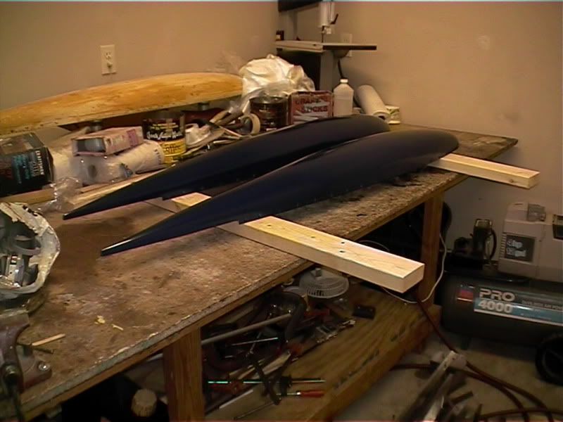

Home made racing tips (slicker than GOS):

Tanks I don't know - tips weren't hard
The tanks are a beautiful piece of work - I'm sure it would take a lot of thought careful design and quality work. Their performance has been flawless and they give me another 1.6 hours at WOT and 2450 rpm.
The tips required making two molds and a aluminum stiffner/closure in the area of the aileron.

Answer to the first question: very close.
Answer to the second question: The racing tips have no lights and I can only fly with them in the day time. I spent all afternoon doing the wing conversion from long range cruise configuration (with landing, nav and strobe lights) to the no tip tank 3" racing tip configuration. I still have one tank to remove and one racing tip to install. It is straight forward but not quick.
