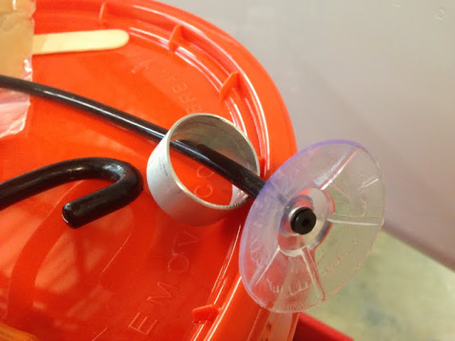

Reading up on this site I read where a fells used a syringe to create the vacuum for the static system leak check. The idea is you can check you system, find and correct leaks before you get the official check. I did not want to crawl into the tail to tap into the line there. What I came up with was this;
I drilled a hole in the center of the suction cup to take the 1/4" hose, I put it over the static port with the opposite one taped over. You have to hold the cup while pulling the plunger, once there is a good amount of suction the cup will stay in place. I taped the hose to the side then slowly set the altitude. I used a snake camera with a removable monitor to give me a view of the altitude window back by the static port.
Set the altitude to 1000 feet or nearly so and then left it for 5 minutes, no change in altitude. :D Now I have a new tool for my tool box.
Start of test: You can see the snake camera pointed toward the EFIS
After 5 minutes:

Ok, so the suction cups are from Home Depot "5lb picture hangar". Drill a hole, press fit some tubing. I used some 1/8" barb fittings that I clipped off as an expansion insert into the tubing. I rigged up a tiedown strap with a hole in it to maintain a secure press of the suction cup on the side of the airplane. I also used fuel lube as a positive sealing agent to overcome the remainder of the paint line. It doesn't take much movement of the syringe to do the trick. Much care is in order.

Scott, good info and photo spread.
One tip for your tip------when you do a hole in something like this strap, burn through it with a heated metal rod, the edges of the hole will not fray.
Well, of course, but I gnawed that hole with my teeth as there seemed not to be another sharp or hot tool in sight at the time. I think I did pretty good, don't you :). I did think about heating up a phillips head screwdriver with the airplane battery... Ok, so I wasn't on a desert island after all.
Two things........ I placed a barbed "T" with a vacuum cap under the panel (well,behind and on top... tilt-up) for static tests. Now all I do is tape off the ports with electric tape and pull a suction from the test T as I sit inside.
I gave up on teflon tape to seal the 1/8" pipe threads on any gauge connection. I use GB (Gardner Bander) 1/2" X 7 mil electrical tape. It DOES NOT shred. But it is thin enough to couture to the threads and seal hand tight.
