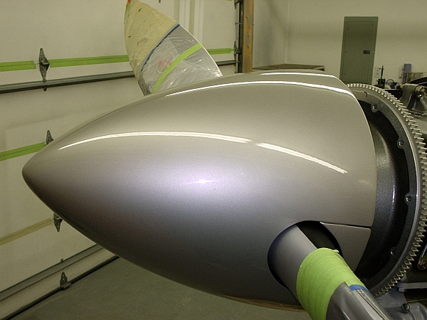

It is time for me to mount the spinner.
I have seen this about screwless spinner...
http://mstewart.net/super8/spinner/index.htm
...and wonder if others have experience of it. It looks nice, but I see two risks with this method. The new layers of fiberglass separates from the plastic of the spinner, or the screws come loose, but you do not see it - in both cases, there is a risk of losing the spinner in the air. What do you think...?
If I make an ordinary mounting of the spinner... what kind of screws is the best to use?
I have it (the "screwless" one) and it looks great.. love it.. I check it before each flight and make sure it's not wobbly... I don't see a reason why the fiberglass would delaminate there... Follow correct procedures for fiberglass application and it should stay on there...
A local builder named Alfio who posts on this forum did his own screwless spinner and did a very nice job.
I'm not concerned about screws backing out of nutplates, but there is a definite risk of flange separation. Honestly measure your fiberglass fabrication skills before attempting this modification. For sure the flange requires craftsmanship. Even with good work nobody can offer a guarantee.

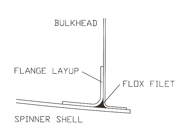

A key detail...composites are always weak in peel. In this case centrifugal force results in a peel load at the flange-to-shell joint. In addition, a glass fabric layup cannot be laid into a sharp 90 degree corner; some radius is necessary.
Both issues should be addressed by installing a flox fillet prior to the flange layup. Here the backplate is covered with red tape and waxed. You can see the white flox fillet. Just wipe it in with your fingertip......
Cross section:
.......then install the flange layup while the flox fillet is wet. Be sure to remove any air bubbles trapped between fabric and flox or between fabric plies.

No mechanical connection, just a very thin proseal surface pad, formed in place. The idea is to make it chafe-proof with zero freeplay. I bonded to the front bulkhead flange and used mold release on a semi-finished inner surface of the spinner. That allowed trimming all excess for best balance; no proseal blobs.

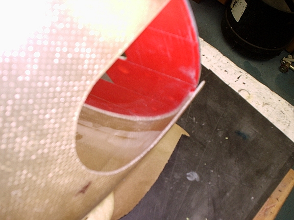

This looks *really* nice...I'm considering doing this. One question...how are the small "filler" pieces behind the prop held in (I assume platenuts on the back, of course...I'm asking about the "tabs" at the forward end...how are they secured to keep centrifugal force from making them flex outward)?

Neither tab is cantilevered as much as it may appear from the outside. One is very short. The other has a support flange tucked under the spinner shell....and probably doesn't need it.

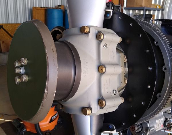

The third and fourth pictures are from the original install.
I had an aluminum "cup" on the end of the prop -- pic 4. The modified small forward bulkhead fitting (attached on the inside of the spinner -- pic 3) would slide over this cup for a very snug fit. Problem was with the vibration and rotation, the screws/bolts "sawed" into the delrin and aluminim to the point where the spinner would wobble a little. I could not tell from the cockpit, but a friend noticed it when I taxied by.
You can see in the third picture the chewing/sawing where the primer/aluminum is worn away near the screws.
This was a more involved process than it should have been. The next/final mod (as described above in the previous post) is by far the easiest and best way to go.

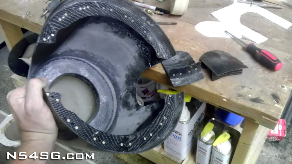

Can someone point me to Dans instructions for making these screw-less spinner filler tabs? I understand how the screw-less spinner is made in this post but not the tabs. Thanks

If your making a screwless spinner anyway, just make the flange all the way around the spinner before you cut the holes for the blades. Then, when the flange is cured, cut out your blade holes and Bingo, you have spacers with a flange to attach them!
Like this pic:
This documents the entire screwless spinner project:
http://www.n54sg.com/spinner-and-bulkhead-overhual/

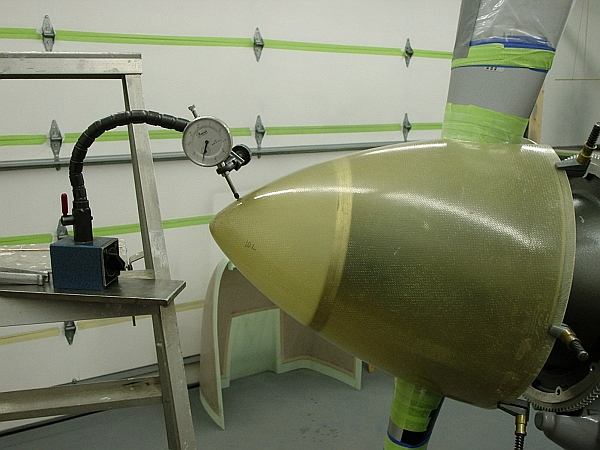

How do you first make sure the spinner is centered and not wobbling?
ETA: Aha...I read your blog and see how you did it (I used Dan H's method and it worked great, but I *really* liked your writeup...very impressive bit of engineering! Well done.. :) )
