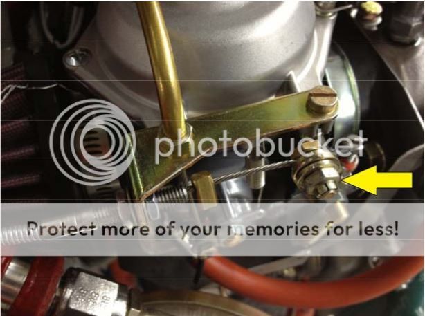

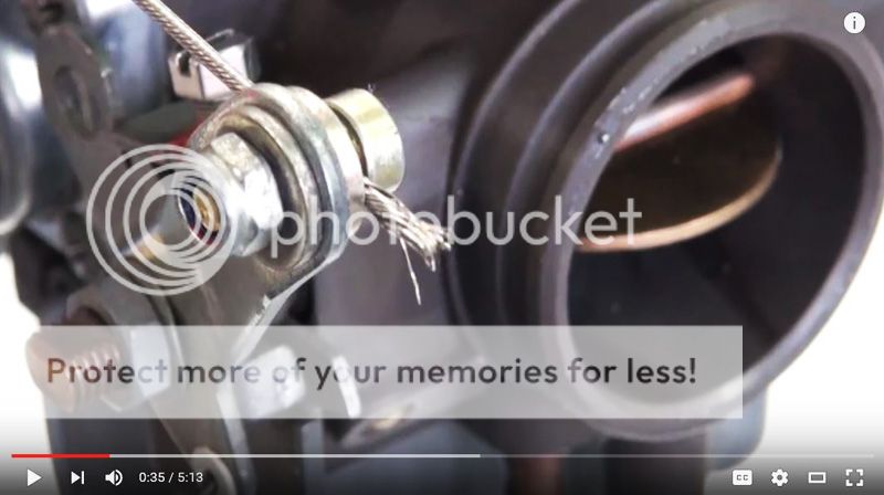

Like most of you -12 builders, we've tried various methods of cutting the throttle and choke cables to minimize fraying. We've used the method in this video on several of our recent builds and WOW!... easy, fast, and the ends are permanently welded together. This tip is worthy of print in the RV-12 plans. (Disregard the nyloc nut... a Van's no no. Ref SB 13-08-29)
Click photo for link to YouTube video
Enjoy... and keep that torch away from the carb.
