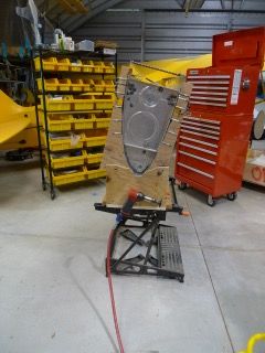

After studying and discussing the fuel tank assembly methodology options and getting past the reluctance to get started, I began with the ProSeal.
Method (Wet or Dry): I opted for the WET faying surfaces, and WET rivet set, one rib at a time.
Used the larger tank dimple dies on the skins and the sub-structure dimple dies on the tank ribs.
Set up tank cradle to raise tank about 8” above cradle base and tilted towards the bottom skin side about 10 degrees, this helped in setting wing leading edge top-side first couple of rivets that would otherwise be in awkward position for rivet gun and holding bucking bar (rectangular tungsten bar).

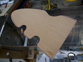

Fabricated a ¼” plywood spreader rib, with reliefs to span over the stiffeners, to spread the skin surfaces apart a bit to ease installation of rib with ProSeal spread on rib flanges. The line along the edge of the spreader rib is the outline of a tank rib (not a perfect representation), there is about 1/4" total added to the rib width for the width of the spreader at the trailing edge and it tapers down to zero at the leading edge. Start with the spreader outline a hair large and test it and adjust to where you feel comfortable with the amount of spread.

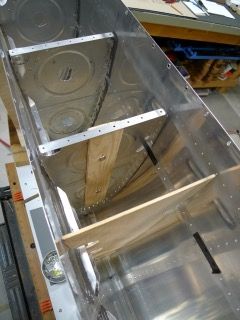

To stiffen fuel tank ribs for installation into tank, because they are a bit floppy, I fabricated two 3/8” plywood stiffener strips with through bolts and wing nuts placed through the rib lightening holes. I found that these stiffeners strips made handling the rib a little easier while applying ProSeal to the rib flanges and made setting the rib into the tank immensely easier. After the rib is clecoed in, the strips can be removed
![](/community/proxy.php?image=http%3A%2F%2Fi1382.photobucket.com%2Falbums%2Fah253%2Fheffnhane%2Frib%2520stffener1_zpsrb2wxkfm.jpg&hash=24cc9604d71c4f31cdcc34a36b0f8a22)
When inserting the rib into the tank, with the stiffeners strips on the rib and the plywood spreader rib between the rib being installed and the next outboard rib, it is easy to keep the rib aligned with the skin rivet holes and to set the rib almost all the way into the leading edge of the tank. I then tapped lightly on the rear baffle flange bend of the rib with a dead-blow shot-filled plastic hammer, the rib set into the tank so that the trailing edge rib flange rivet holes top side and bottom side aligned to within a 1/32” of their corresponding dimpled skin rivet holes. It was easy then to insert a cleco into the two trailing edge rivet holes, and then alternating top to bottom skin insert all the clecos down to the leading edge rivet holes. Trying to start the clecos from the leading edge was much harder to get them started.
