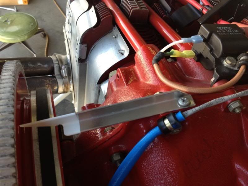

Not an RV [engine is on the wrong end of the plane :) ] but here is an index pointer for verifying dynamic timing on the LSE. Most Lycs have a machined boss on the spine that allows tapping a **small** hole to position the pointer. Checking the LSE timing with an automotive timing light is the only way to verify the ignition timing varies with MP and RPM per LSE specs. Klaus is also adamant one should verify mag timing dynamically with the same auto strobe light if a mag is retained.
