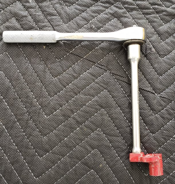

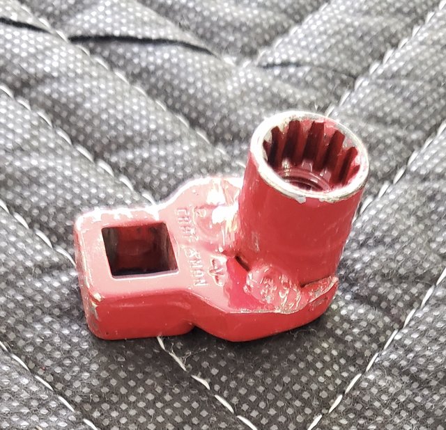

I made this offset socket to torque the nuts in the gear towers. It’s a 12 point 7/16 socket driven by a 1/4” drive 9/16 crowfoot wrench and brazed tougher. The 1” offset allows you to reach under the vent lines. You do have to compensate for the offset in torque setting but It’s pretty easy to use.

You can grind off the margins of the crowfoot to get more wrench clearance.
Mike
I was talking to myself about how much that wrench cost. I bought both the socket and crowfoot from McMaster. Built the way it is shown it drops right on the nut and you get just enough rotation to move one flat on the nut.
Thanks. I will just get the 1/4" Crow foot, replicate your design, and quit being so cheap. Have to spend the kids inheritance somehow; what better way than on aviation and tools!
This would be a fairly easy tool to make just using the 1/4 inch extension, a piece of steel, socket and welding it all together. Most of us have the cheap HF stuff sitting around anyway.
Thank you for posting this. Tom Doran (local RV-8A guy) welded one up for me using 3/8” drive socket and crows foot then ground down the crows foot edge after welding. Now the rear nuts in the tower are easy to do.
Carl
What's the process for compensating for the offset in torque?
