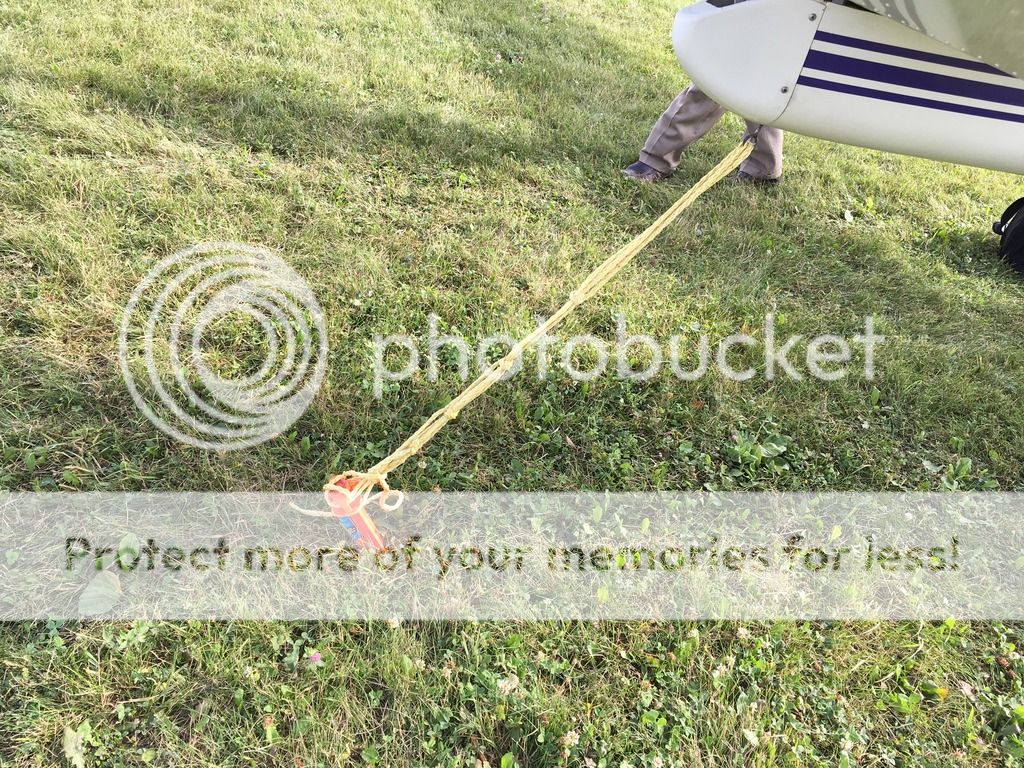

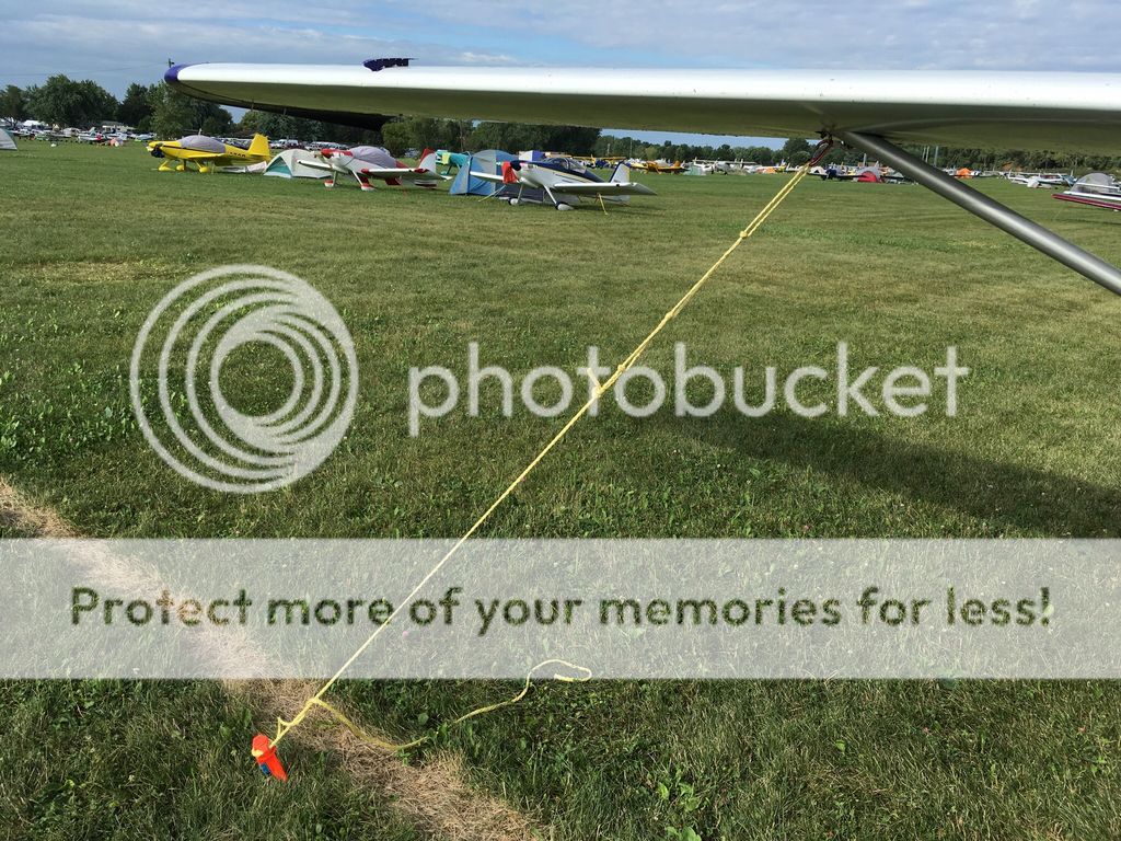

So, here are a couple of photos of 2016's "worst tie down at Oshkosh" award. Maybe some of the rope experts here can comment on these knots... not to mention the plastic tent stake or the cheap carabiner.
Note that on the tail, at least he doubled up the ropes a couple of times. That ought to hold it.
This plane sat in this condition in Homebuilt Camping through Saturday morning. I spoke to the owner as he was leaving- he was a little embarrassed when I gave him "the lecture" but that sort of misses the point. Other airplanes spent the week tied down right next to him- did any of his neighbors take this up with him? There is only so much that EAA or any fly-in organizer can do- but peer pressure can go a long way. So be polite but proactive when you see this at a fly-in.
