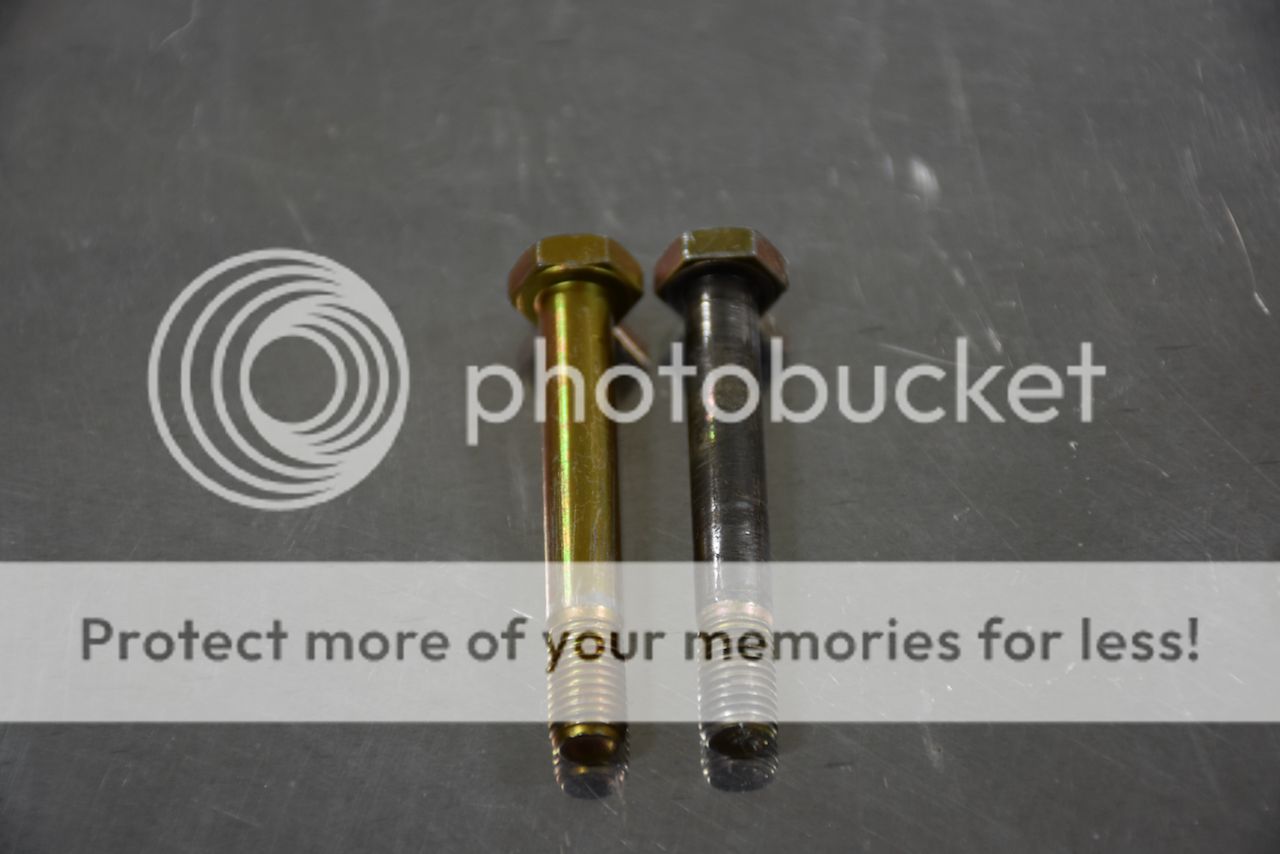

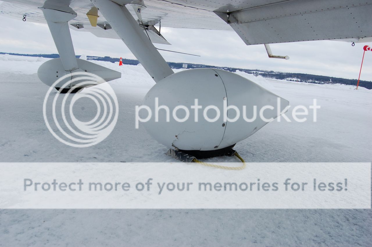

I use thread locker in two places on my airplane. Nose gear bolt and all wheel fairings screws. The torque seal on gear bolt is checked and reapplied every condition inspection ( bolt replaced every three years on average)
Wheel fairings get the hardest beating and lowest screws are always backing off. Thread locked with blue loctite. Pictured at Ottawa River ice flyin, Canada.
