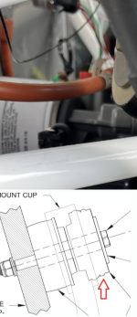

John, at the risk of getting burned by the flame war on the horizon, I'll answer this. Obviously a rigid tube has a smaller OD for the same ID as a hose. Sometimes a tighter bend radius, depending on the bend die thats used. In the above pic, the multiple bends will absorb any vibration and potential misalignment. It does take practice, patience and skill to make a custom rigid tube like that. That being said, most builders dont have the tools, practice, or time, and use teflon hoses. YES, teflon has a larger bend radius, especially with firesleeve. Yes, teflon is not life limited, and somewhat easier to use. I can tell you that making custom rigid tubes for installs from emails or non prototyped drawings is tough, and generally wasted time and expense. You never know if its going to fit, unless you are actually at the plane and do mockups. and you never know if there is something that will interfere with the tube. Pic below was Michael's I0540 circa 2018 with his stainless tube. Well designed, supported and fabricated. So, for most builders, teflon hose is the answer, but YES YMMV.
