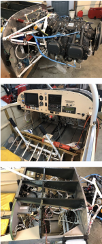

Build Update …KazooRV-9A
Getting closer to putting the RV-9A up on the main gear. Am looking forward to that visual progress! All FF wiring is complete, and have been testing the EIS/EFIS inputs before riveting the top front skin in place. Wiring and panel installation has been a long process.
