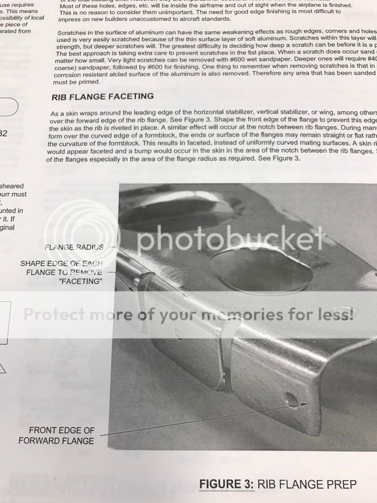

So despite the warnings abound about the nose ribs denting the skin on the vertical stabilizer skin, and despite grinding the nose ribs down to what it appears others have done (about 1/8") I managed to get a bit of dimpling particularly the middle rib. The outward dimpling remains after removing the skin following the match drilling. It's not huge but noticeable to me.
I was wondering if there was a way to remove them or should I just accept what is and move on?

Don't know that there is any good way to remove that dimple (without replacing the skin) but believe me, there will be many more areas that will be nearly imperceptible to others and drive YOU nuts.
You just need to decide how many times you want to rebuild something before it is good enough...
NO ONE has built a perfect airplane...everyone has their "less than perfect" areas...:D

This is but a small problem. The thing that PO's me is that it's a well documented gotcha. Until the skin is in place though it'd difficult to tell if you rounded the ribs enough and by then it is too late.
One thing I had considered was centering a bucking bar behind and giving it a short couple taps with a flush face rivet gun. I don't know if that's been tried before but it sounds plausible to me.

One suggestion.... I did get a small "dent" on a skin from laying it on something on my work bench. I took a hardwood block of wood for the back "bucking bar" and a smooth brass hammer head to the dent side and simply pressed on the dent against the wood. Seemed to work good for me. I felt is was more forgiving than the rivet gun pounding on it.

I emailed Vans about this issue as I think it's a pretty big deficiency in the plans. They said its in section 5 (is that right?), but I don't recall seeing it. It gets most people, in my view it needs to be mentioned in section 6

It's not mentioned at all in Section 6. I think it would be a nice addition to the plans. I think it would be nice if there were a more explicit guide as to exactly how much of the rib to remove. My guestimate of about 1/8" as per other builders was just a tad too conservative.

It's definitely in there
Like some others, I was aware of it, ground off an amount to where I was beginning to worry about the flange material becoming too thin, and I still got some slight outies. Drove me nuts initially - thought I'd rebuild the VS at some point because of them. Several years later, I can't even notice them.
I had a similar experience but I read and re-read (several times) the part in section 5 about this issue and I still ended up with small dimples. It makes me feel a little better knowing that so many others have the dimples too even though they knew they needed to shape the nose ribs some more.

Once a skin has a protrusion, the skin is stretched and a tiny bit thinner in that region. It's hard to make it shrink back to its original size. Also, aluminum is very flexible and only after you get past the end if its elasticity, will it change shape permanently but that also gets you close to the region where it will develop a crack. It's best to just leave the blemishes alone and live with them.

So the ribs would have to be ground a long way down to prevent this. Why? The skin is under a lot of tension, held up at both ends by ribs so that nose rib is doing it’s job keeping the middle in shape. If you…like I…. Keep fiddling the rib gets shorter and shorter trying to ensure the bend from the web to the flange is not “sharp” a sure recipe for cracks to appear. So you round that part to ensure the rib has no sharp edges. Also the faceting instructions show a little ground off area when in fact looking at any nose rib on a compound curve is less that flat after punching and bending. They look better after dimpling.
Try fluting
I didn't like the idea of grinding those flanges back too much and having an edge distance problem with that first rivet. I did grind them back some but also fluted the rib web ever so slightly to narrow the distance between the flanges. Helped to eliminate the faceting in the skin.
