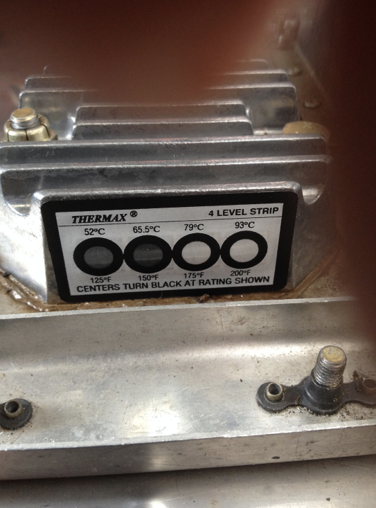

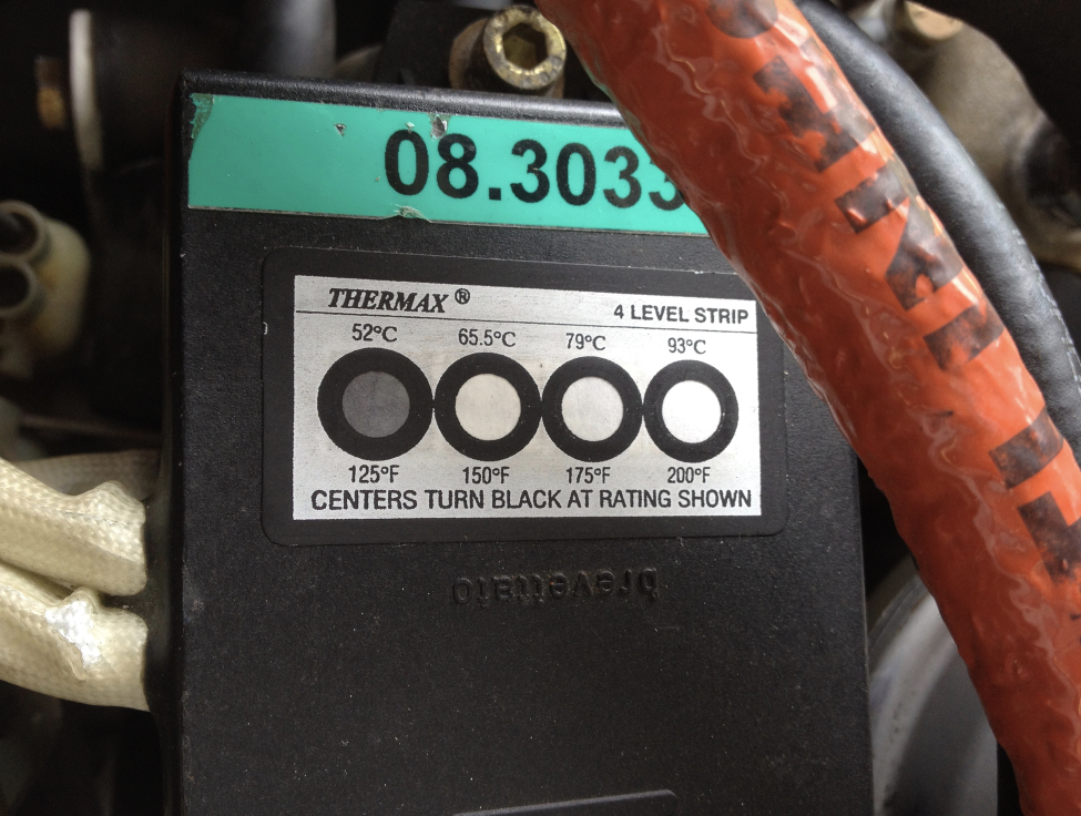

Before flying season started this year I placed two temperature recording strips under the cowling of my RV-12 - one on John Deere Voltage Regulator and one on top of ignition unit. Hasn't been hot yet (northern Ohio) and only four flights...
