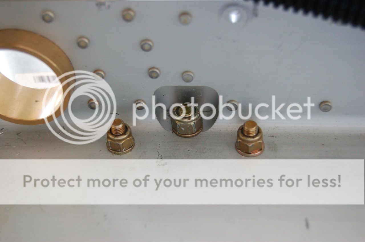

Gents we completed landing gear install per SB. All hardware callout was by the book however we have doubts if there is enough thread showing on the middle one. Opinions please...
It looks a little short to me Vlad - as I bet it does to you (or you wouldn't be asking).
to short
To short the shank ( the grip Length ) needs to go all the way to the washer
The length of AN aircraft bolts is measured from under the head to the end of the bolt.
The Grip is the Length of a portion of the shank that has no threads.
AN960 flat washers are used under hex nuts to provide a bearing surface and as shims to obtain the correct grip length for a bolt and nut assembly.
A thin washer will not work in this situation.
It looks to me like it does just meet the minimum
The requirement is 1.5 threads exposed. This refers to the end of the physical interface which is not necessarily the plane of the end of the nut but the end of the locking device. I have one or two minimum length bolts/screws in the airplane. As mentioned earlier you could substitute AN960-XXL washers for the AN960-XX washers to get a little more exposed bolt thread.

Aren't the other two a little on the long side as well. It's hard to count, but it looks like 4-5 threads on both of those.
The nut is fully engaged! Personally though, I like to see two to three threads. I would change it.

Just finished the SB and have the EXACT same condition as shown in the photos. The bolt is too short, or a thin washer may rectify.
This is quite odd. Worried that mine may not be good, I just went out and photographed mine, no problem! I think Scott mentioned once during the SB talks, that extrusions are not precision, but vary from plane to plane somewhat. I had a problem of the cherry rivets being too LONG. Maybe I have a thin channel?

The thing that would bother me here is that everyone else seems to get two or three threads past the nut (mine too). This seems to indicate that the configuration is wrong. Possibly too short a bolt, too many washers or misaligned parts. It's usually best to look like everyone else's RV!
Washer mix-up?
Page 31 of 36 of the SB calls out NAS1149F0532 (thin) washers under the heads of the bolts.
The inventory on page 2 only lists the (4) NAS1149F0563 (thick) washers for under the nuts.
So, if you are using a thick washer under the head instead of a thin washer like shown on the drawing page 31, then that could account for the short thread pictures. Or, if you used no washer under the head, you might see more threads. Don, what did you use under the bolt heads?

Here's a marginal quality iPhone pic of mine. More thread visible than Vlad's, but not as much as Don. I used the exact hardware included from Van's. Now we have three photos of the subject area, but from what I've read, I'm not sure we've reached a general consensus as to what's acceptable?
In this instance, meeting the standard self locking nut rule of thumb (minimum of one thread visable) is entirely acceptable.
As Joe pointed out, having bolt shank baring on the entire I.D. of the holes would be the most desirable in high load cases. In this instance, the highest loads on the bolt are in tension (in aircraft, most high load fasteners are in shear). Also, since it is very thick material (1/4"), the bolt size installed would be fine as long as the one thread visable guideline is met.
There are a number of tolerance's interacting here. The length tolerance on a standard AN bolt is pretty loose. There is a tolerance on the aluminum C channel extrusion. Another possible issue is whether the bolts have been seated with a drift and hammer as described in the S.B. (and I believe the latest Rev. of the construction manual).
In the end, it is builders decision. The bolt called out is considered to be sufficient for the expected tolerance range of parts, but the builder is the one that has to certify that the airplane is in a condition for safe operation, so they should use their own judgement (using AC43.13 and other aircraft standards documents) in determining whether it is appropriate.

I personally would be more concerned about the two outer nuts bottoming out in the last pic posted. I would add another washer.
That has bothered me as well, I am considering putting another washer on them, sure look marginal at best..

Once the bolt's full threads have engaged all the metal threads in the nut, it'll be as strong as it can be in tension. The threads through the nylon part are not for strength but to ensure locking, and you need to have the appropriate threads sticking out of the nylon to be sure that the nylon is doing its thing.
Also, I side with the folks who said that a thin washer is adequate. It is. Think about it - with the nut and bolt in tension, the channel will, before failure, deform and shift the load from a distribution across the bottom of the nut which tends to be greater close to the edge of the hole, to one where the nut is more strongly loaded around its periphery. That'll happen whether the washer is a thin one or a thick one.

Perhaps I am wrong, but I think the objections to the thin washer were that it might allow shear loads to be applied to the threaded area, if the threaded area were inside the material (bolt shank too short). Nothing to do with the washer itself.
My concern has nothing to do with the amount of bolt sticking out past the nut, the height of the steel part of the nut is the same as the diameter of the bolt. When the bolt is all the way in the nut, the assembly of the bolt and nut are considered the same. a thread and a half is adequate for projection.
my concern is the shank of the bolt and trying to compare it to the number of threads of projection.
The key is the shear connection of bolt shank and the last item of the connection closest to the nut.
The last item should have the shank in at least 70% of it's thickness.
The trouble with saying that it looks ok because of the number of threads showing is the layman will think is ok in all similar conditions.
The total connection may have two or three shear points and must have the shank crossing them all.
Understanding a bolt assembly is vital.
The 1/4" U Channel should have the shank in a least 3/16 of a inch (75%) to be a good connection.

I took some quick and dirty measurments and it looks like with a minimum of one thread exposed it would leave between 1 - 1.5 threads of the bolt within the bore of the hole when using the specified washer.
With a thread pitch of 24, that would be ~ 1/16 " inside of the nominally 1/4" thick channel, which means shank baring on 70 - 75% of the holes bore ( a little variation because of the small radiused transition between the threads and full shank diameter).
Now that is the right answer

It appears that in the example the grip length of the bolt is not a critical factor, only the engagement of the locking portion of the nut is critical.
If you closely examine a large selection of AN bolts you will find that the unthreaded portion just before the start of the threads is frequently smaller in diameter than the rest of the bolt. If the bolt is engaging a thick part this is not an issue.
Lets examine a hypothetical. A strut braced wing with a single strut on each side. The wing fittings are two pieces of .063 channel with .063 reinforcements welded to the channel. The long AN6 bolt goes through the channels and the strut in the middle. In this case I firmly believe that the BEST method is to use a bolt one dash number longer than required. This insures that the relatively thin fittings are fully engaging the full size diameter of the bolt. The number of washers is a distant second in consideration. I don't really care if it requires three washers or five, this is structurally the best technique and I will argue this with any FAA Inspector or DAR.
The number of threads exposed is only a rule of thumb. This varies with the size of the bolt as the threads get courser as the bolt size increases. The critical considerations are that the unthreaded portion fully engage all parts in critical shear situations, and that the nut does not bottom out on the thread.(not enough washers)

Why not just go to the next longer bolt if you're worried about thread engagement?
I decided to try the next longer bolt (an AN5-23A). Assembling the hardware on my plane with a thin washer (per plans) under the -23A bolt head the nut will bottom out on the bolt shank. Even with a thick washer under the bolt head it looks like the nut could bottom out when considering there is possible variation in channel thickness.
So I concluded that the AN5-22A bolt, thin washer under the head and thick washer under the nut as specified in the plans, is the right setup. Scott, you knew that of course. I should have been faithful.
The only issue I see is that the thin washers are not included in the kit, and some may be using a thick washer under the bolt heads which could result in only about 1 thread or less showing.

Sure. I have thin under bolt head, thick under nut, and mine looks like Vlad's original photo. I'd call it marginal but OK, and will likely improve when re-torqued. If not, I may remove the thin washer, but as the forward bolt is mainly in tension, not shear, I'm not too concerned about bearing stress on the channel web.
There you go - 5 and a bit! :)
I believe this oversight has now been corrected.
It should have been caught right away but this forum is not used as the official notification point for kit an plans issues. Not all things get seen.
This just amplifies the need to also contact someone at Van's when issues are discovered.
