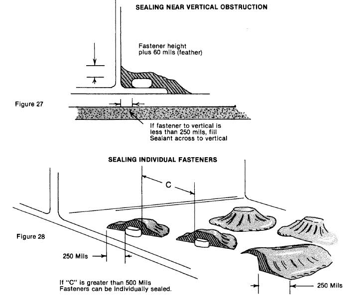

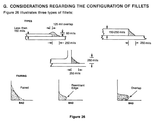

There are different types and three are useful.
Type B is the common one. It comes in at least two and I think three speeds of setting, 1/2 hour, 2 hours (our most common) and I think 4 hours.
You can also get an "access hatch" sealant, with the same consistency as the common type B, the same speeds of setting, but it's supposed to come apart easier if needed for opening access hatches. Also it's sort of pink.
The third type is Type A. This has the same color and setting time as Type B, but more of a honey-like consistency. It's used for spotting over rivet heads and along seams, after the regular Type B has cured. These pictures illustrate that.
In the following pictures, a "mill" is .001 inch, or 1/1,000 of an inch. 250 mills is 1/4 inch.
and
