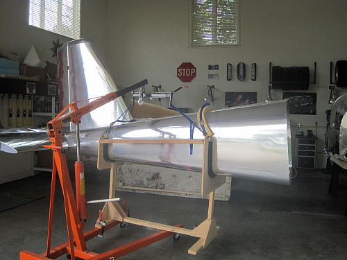

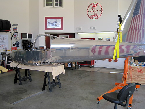

I attached the stabilator once and never removed it again. I also attached the tailcone to the fuselage with the stabilator and vertical stabilizer attached AND I did it by myself. It can be done without it being a big deal if you choose.
