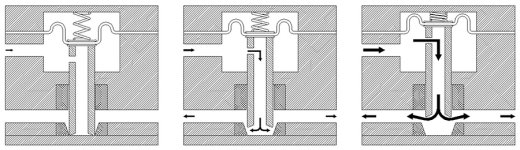

Does the spider di·a·phragm really move down to expose more of the fuel ports?
A quick search yielded the attached description. Note that as the spider diaphragm moves, the fuel “V” for each cylinder is more exposed. The small opening at the apex of the V provides for a leaner minute and smooth idle.
https://precisionairmotive.com/wp-content/uploads/2019/06/15-812_b.pdf
To verify what is going on, I suggest the “shot glass” test. This is what demonstrated our issue with a chunk of crud in the spider. Here is our test result:
