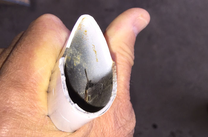

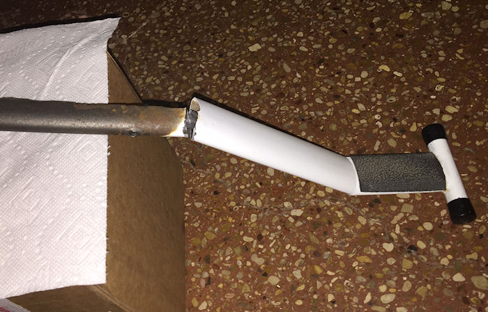

The pilot side step (WD-1233-L) failed as I started to man the aircraft. WD-1233-L fractured at the lower end of the welds on both sides of the channel that mounts the step to the fuselage. The step did not separate completely and ended up hanging from the bottom of the airplane. I removed and inspected the right side step. WD-1233-R appears to a small crack at the end of each of the 2 welds where WD-1233-L failed.
Other than being surprised by the step disappearing under me there wasn?t any problem. If the step had failed when I was exiting the aircraft then I might have had a problem.
I?ve submitted a RV-12 Feedback Form (Safety Alert) to Van?s Engineering this morning but I wanted to get the information out so you can take necessary precautions when getting in and out of the airplane.
I am 6 ?5? tall and weigh 215 lbs so the pilot?s side step does get a work out. I am trying to confirm that there are cracks on the passenger step since it doesn?t get the weight and cycles that the pilot side does. I?ll update the passenger step information when I get an expert opinion. The aircraft has logged 268 hrs over 380 flights.

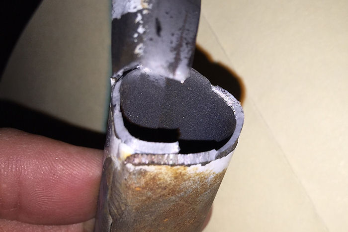

Identical Step Failure
My pilot step broke exactly in the same place as JBPilot. It is at the end of the last weld on both sides of the U channel. It appears to me that there is a stress concentration at that point and it is just a matter of cycles before the step breaks. There is no way you can inspect for a crack in that area without removing the step. Still waiting to show my passenger side step to a structure's guru to confirm that I have cracks starting at the end of the same welds.
I had not seen JBPilot's earlier post about his step failure. With as many RV-12 pilots reporting broken steps it is amazing that someone someone hasn't been hurt.

Step Weldament Failure Upate
Van?s replied to my step weldament Failure Feedback Form with an acknowledgement that ?the step has a propensity to crack over time?. Also, that Van?s has an open project looking into the issue but no timeline for the release of a new step. It was Van?s recommendation that I install another step of the current design in the interim.
I received my new replacement step weldament on 11/20/15. The new unpainted step has two small round bumps on the exterior in line with the U-channel on each side of the weldament which extends about 1 ? inches beyond the point where my step failed. These bumps may be evidence of tack welds to hold the components in position for final welding or the bumps may be spot welds to weld the lower part of the step to the channel extension. The consensus of my experts is that these are spot welds intended to weld the lower part of the step to the channel to distribute the loads over the full cross section of the step rather than the partial cross section where the failure occurred. Examining the interior of my failed step below where the step fractured you can see and feel two small bumps of discolored metal protruding from the interior surface. On the exterior of the channel that extends below the fracture (the channel was cracked but stayed with weldament part of the step) you can see a couple of small spots where the metal has been melted but without any significant penetration. These observations suggest that these areas were intended to be spot welds (2) on each side of the channel but did not penetrate the channel enough to fuse the two parts together.
I talked to Van?s Tech Support last week and was told there were no spot welds on the step. On 10/17/15 I sent Van?s 2 photos of my failed step. The exterior spot weld bumps did not show up well since the step was painted. The 2nd photo of the interior of the step clearly showed 2 rough discolored circular areas of heated and melted metal that supported the spot weld explanation. On 11/20/15, I sent Van?s a photo of the unpainted replacement step with the two exterior bumps clearly visible and asked for an explanation.
I received an answer to my 10/20/15 e-mail from Van?s today (11/23/15) confirming that the bumps on the step weldament are spot welds and are intended to penetrate into the channel. The spot welds on my failed step did not penetrate into the channel so that confirms what my experts have been telling me. Since there is no way for me to determine if the spot welds have penetrated the channel (on the new step and old passenger step) we plan to Rosetta Weld each of the 4 areas on each step weldament where the suspect spot welds are evident. This will insure that the parts are welded together and that the loads are distributed to the entire cross section of the step. The Rosetta welds may not be the final answer to the step failures but it goes a long way toward making sure that weld penetrates the channel and loads are distributed as intended.
