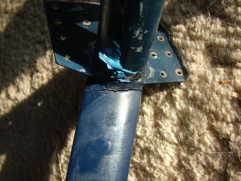

Climbing aboard yesterday when the left step broke off. I got some nasty shin damage but the flap survived.
The airfoil shaped drop down piece broke away from the tube that inserts into the fuselage. It looks like when it was manufactured, they weld a flat plate across the tube then weld the airfoil shaped drop down piece to that flat plate. The flat plate held but the drop down sheared off of the plate. It sort of looks like they ground a little too much of the weld away. This had been cracked a long time as it was rusty along 2/3 of the contact area.
Look yours over for any signs that the weld is failing, i.e. rust stains or visible cracks.
PM for photos.
I had mine break also, I attribute that to too much cosmetic grinding or removal of weld to smooth surface during construction. Had to get rewelded and so far so good.

I called Van?s and they seemed to have never heard of this. I came to the same conclusion, they ground off the weld. My shins paid a dear price to the trailing edge of the flap. Luckily it didn?t damage the flap.

First flight 2011, was a Phoenix based plane. And I am sure this was a manufacturing flaw not a vibration issue. There was almost no weld left after the cosmetic grinding. TT <600 hours.

It is usually the right step. While my right cracked before 100 hours; Left is going strong at 600 hours. This makes me believe it is a vibration or harmonic issue. My left is used 20 times more than the right and always heavier folks on the left.

My step broke at the weld. The photos you show are classic case of not stress relieving a weld. It makes the metal fail where it was heated to weld without heating a larger area to stress relieve it. I am sure that the weld was ground down to make it look good and left little or no weldment to take the stress.

Just to clarify, neither Vans or its welding vendors (in instances where the welded parts are outsourced) grind on welds before shipping welded parts to customers.
If you are certain that grinding was done, it likely occurred during the build process.

Thank you Carlos, if there was no grinding, then there was never any penetration on this weld. It was holding on by a thread.
This plane was built in 2011 and flown in the Phoenix desert until May 2018 when I bought it with 500 hours TT.
Even if the weld was ground down there was inadequate penetration on the base metal. It was defective from the Mfg.

I called Van?s to axe if they wanted this step back to evaluate the failure. The response was that the photos were enough for engineering.
Please look yours over closely for lousy workmanship as a failure can damage both plane and pilot.

Look for any signs of rust or cracks. I based my comment of poor penetration on the opinion of the welder that repaired my first one. When he grinds down the second one, I will share his opinion. From the fact that the crack is right down the center of the weld, I am guessing it is similar.

Picture of 6a broken step
Pilot side now broken, passenger side has already broken and has been repaired via weld.

I am not an expert welder but it is my opinion that the weld was not well done, it had poor penetration of the two surfaces. There was also some rust present. Since my plane has been flying for a decade, I am assuming that Van’s tightened up the quality of the folks they had producing these steps.
It is easy to see a crack forming if your weld starts to fail, I do not think it needs a gusset.
