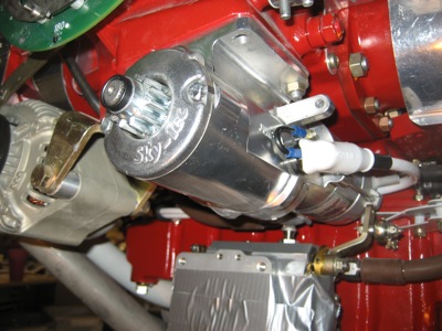

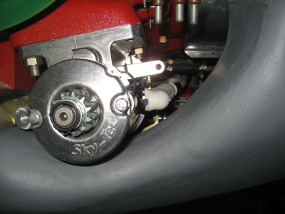

It fit okay in my airplane, Scott, once I ground off the superfluous mounting lugs in accordance with Skytec's installation instructions. I had to do a bunch of fiberglass work to get the snorkel to fit around the alternator, but the starter required no fiberglass modifications.
(note: the above photos were taken during the fit-up process, all fasteners are temporary)

Temporary?
Is it just temporarily fitted? There is a missing stud/nut on the forward left mounting hole of the starter to the engine.
Vic
Vic
It is missing, but on my O-360 that is listed as a bolt, not a stud/nut.... much easier to add later... :)

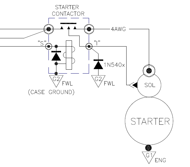

I guess I need some more educatin then.... I'm familiar with PFM (I gotta feeling that's what this must be) or this is just over my head :confused:
The original purpose of the 'I' terminal was a convenient place to pick off 12v during starter operation to bypass the coil resistor for better spark back in the day when cars had real distributors and one big coil.
You can see from the diagram below that the 'I' terminal is connected to the starter terminal inside the solenoid, this is just a bit "upstream" of the starter itself so unless there is some PFM happening somewhere in the wiring I'm not sure I understand what difference it would make connecting the solenoid using the 'I' terminal rather than the connecting it to the starter terminal.
Maybe that's why Skytec, who have some pretty smart folks working for them, can't seem to figure out why Van's does it this way.

Walt, I think your schematic symbol for the contactor is making it more confusing than it is. Bob Nuckolls posted a better schematic symbol a while back that makes it more obvious what's going on.
The "I" terminal isn't connected to the exact same node as the output of the solenoid. It's a third connection, independent of the input and the output.
When the contactor opens, the "I" terminal disconnects from the output of the solenoid, which is not obvious from your diagram given the schematic symbol used in it.
Does that make sense?
Thanks Gerald.
Your diagram shows the mode of operation that I understood occurred, but at this point I will take nothing for granted.
As soon as I get a chance I will be taking a close look at how the start solenoid operates.
I will report here what I find.
Edit: After doing a quick search I found this text written by Bob Nuckolls in the discussion thread where the above diag was originally posted...

Great find on the diagram (I grabbed one off google), like Scott I think I have a couple of solenoids at the hanger that I can actually check operation of to see how they work, if they are wired the way you've shown in this diagram than that would explain how the Van's wiring would work (maybe all solenoids aren't the same?) Just goes to show you can't always trust what you see on the internet!
Update.. I found where Paul Dye dissected a starter solenoid and the 'I' terminal is connected to the center disc which disconnects when the relay drops out so the Nuckols diagram is accurate and the one I posted from google is not.
So if you have a PM starter I agree that Van's method looks like an alternative method to wiring the starter that may improve starter operation. Be sure to use a heavy gauge wire in the circuit as the starter solenoid draws a pretty good current.
I officially apologize to Van's and Mr. Daniels for ever doubting them! (and don't always trust the stuff you find with google!)
