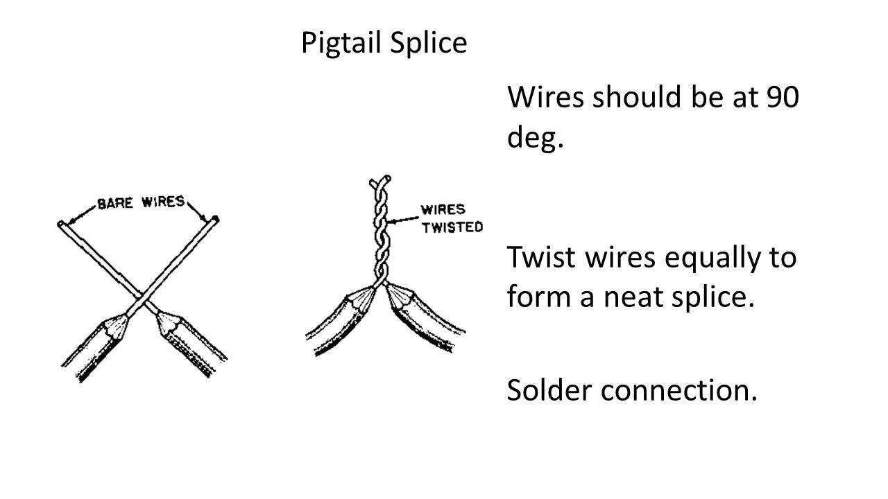

Parallel pigtail splicing can also be used but it is ugly. That's when two stripped wires are laid in the same direction so their ends are even and then soldered or solder spliced. Since there is now an open end heat shrink is applied after soldering and doesn't have to be put over one of the wires prior to soldering. Think of wire nuts in home wiring. Looks yuky but works. You end up with a kink in the wire run where the wires are brought together out of plane. Pigtailing is more common in situations like the Garmin bare wire cables for portable GPSs are connected to airframe wiring. Those little wires are sometimes 28 gauge or smaller and gnarly to twist together for an inline butt joint. It's easier to pigtail them. In your case pigtailing might allow soldering the shielding to each other since they will lie along side each other.
Kind of like this image except the stranded wires are laid parallel, not 90 degrees:
