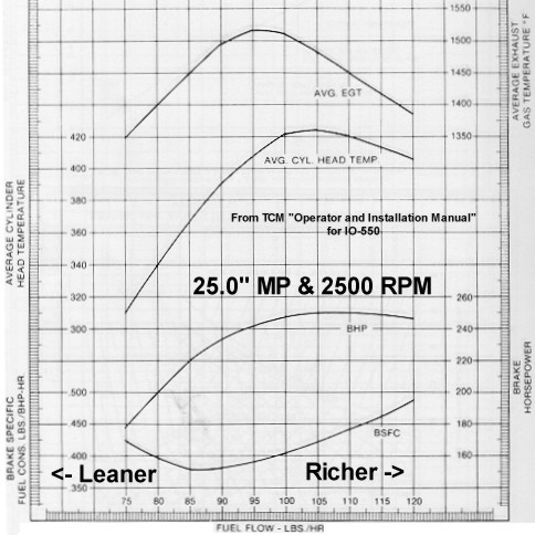

What is the BSFC of a Lycoming or Continental engine?
Just for comparison, my V8 is between .40 and .50, with an average burn of .45.
Here are the latest numbers from the dyno runs...
4000 rpm:
24 inches = 345tq 260hp 19.5 gph
22 inches = 324tq 246hp 18.7 gph
21 inches = 303tq 235hp 16.2 gph
3500 rpm:
24 inches = 335tq 220hp 16.5 gph
From 4000 to 3500 the torque values are about the same but the hp drops about 40.
This comes in right at .45 lbs / hp / hr. Right on schedule for a high performance V8.
What is the hp/torque at 75% power? RPM / Manifold Pressure?
Is that pounds per hour per horsepower? If so, those are awesome numbers. We will not run LOP.
232 HP for an IO-550N. Fuel flow at 75% best econ is 88-90 lbs per hour. TQ isn't specified but calculated should be about 488 lb-ft
The IO-550G is better but is only 210 HP.

The answer is Lycoming is supiror to any alternative engine... proven over and over.
The HP, FF, BSFC, charts are in the Lycoming manuals. This is for a Continental, BSFC looks like 0.38 is lowest.

If we are talking auto engines here, the latest SI engine designs from Toyota match the BSFC figures of auto light diesels. Toyotas Dynamic Force engines, introduced in 2018, have a thermal efficiency of 40-41%. https://www.sae.org/news/2018/04/toyota-unveils-more-new-gasoline-ices-with-40-thermal-efficiency
This is because the compression ratios are in the 13-14 to 1 range and the Otto Cycle is actually more efficient than the Diesel Cycle.
Diesels also don't produce more torque or more power than an equivalent SI engine of the same displacement at the same boost pressure. If you have an apples to apples example to support your statement, please cite it here.
Most OEM SI auto engines require a very rich mixture (around 11.0 AFR) at high power levels to keep piston crown temperatures down to survivable levels.
Despite the generally old tech in Lyconentals, they are surprisingly efficient at cruise. Running LOP in cruise, they can match the BSFC figures of 2 stroke aero diesels (think WAM) and come within a hair of 4 stroke aero diesels such as the Austro and Thielert. With the addition of high CR pistons, EFI, EI and tuned length intake and exhaust systems, they can match the diesels on cruise BSFC.
