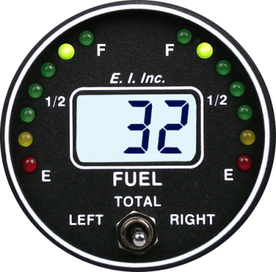

Here is the gauge I've been using with the stock Vans senders since the RV-6 first flew in 1999:
https://iflyei.com/product/fl-2-dual-fuel-level
The gauge is very accurate after the first 3-4 gallons are used (this is a function of dihedral in the wings) and blinks to let you know when fuel imbalance has reached a certain point.
same config as Sam points out to above… the most precise fuel indics I’ve had on any airplane :)

This is what I had in my -6 and am installing in my current project. Love this gauge!
I think I have an EI dual fuel gauge as pictured that is sitting on the shelf. Make an offer if interested.
