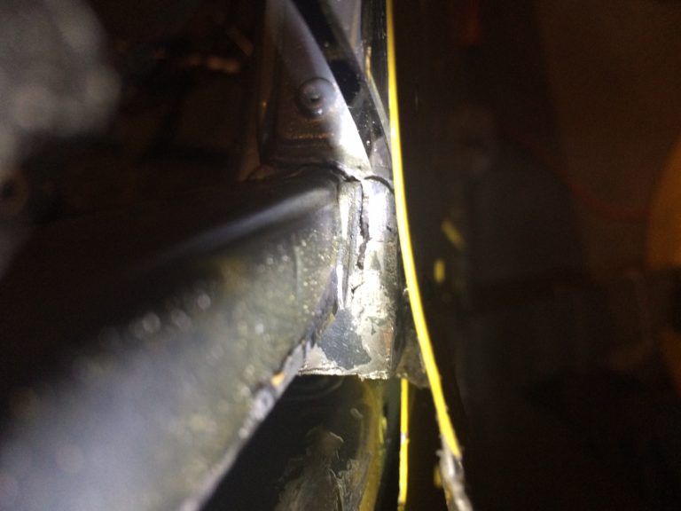

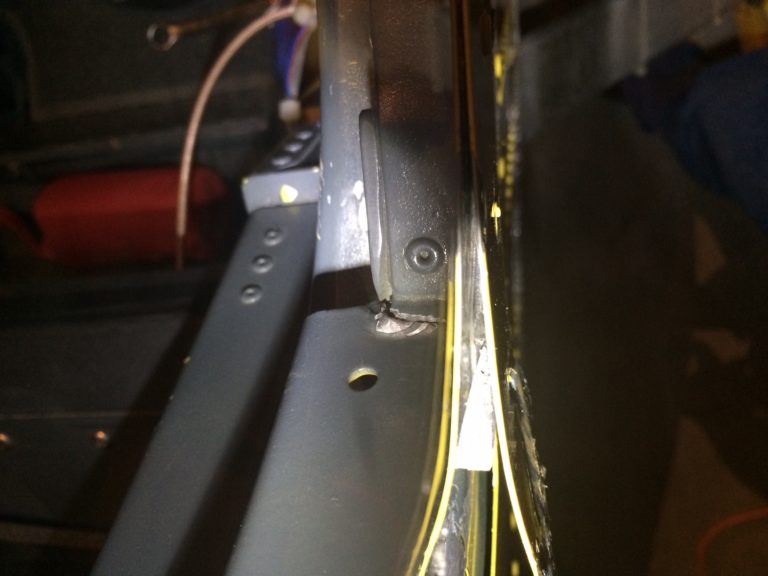

My new canopy parts will be here Friday. When repairing the plexi I found a broken weld on the frame, and decided I was fighting a losing battle trying to fix it. I'm building a complete new canopy. I like the Sika idea better than screws & rivets, but haven't yet figured out how it would be done on a 12. I'm still researching.

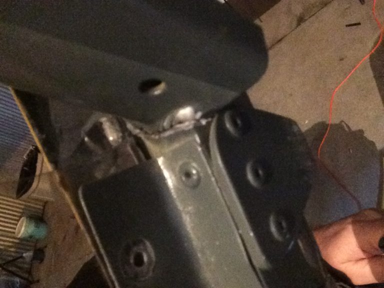

I could... but I'd have to replace the canopy anyway, re-do all of the fiberglass, and spend a lot of time cleaning up the old frame to re-do it all. Then I'd have to drill all the canopy holes and try to make them match the holes in the frame. And hope whoever did the welding had the frame jigged straight. In the end, the added cost of the frame ($325, compared to the $1100 plus crating and exorbitant shipping I was already in for) to not have to screw around trying to salvage the frame. It wasn't just a crack; the right lower end of the bow was completely broken off of the lower rail. I've got a couple of temporary reinforcing plate riveted in there until I get the new one built.

Dale, could you provide a picture of the damaged frame? It would help making a thorough inspection of ours. This kind of damage is somewhat surprising as I understand you bought the plane recently and probably have had the plane inspected before purchasing it.
You wouldn't see this kind of damage unless it had happened due to a pretty severe impact. You are, I believe, familiar with the plane in question. Based on the damage to that corner of the canopy and the F-1254 support frame underneath it, my guess is that the wind caught it and slammed it shut at some point, and it came down crooked. There's a dent where the tab on the bottom of the canopy missed the slot and impacted the support rail, the acrylic in the corner was broken and the skirt was not too pretty there.
We saw the external canopy damage during the pre-buy inspection, of course. It was a little ugly but limited in scope. Aside from the broken corner of the acrylic, which could be fixed with the right adhesive and a little careful work, it didn't look like a big deal. The broken weld was not obvious. It was only when I started taking apart the patches and previous attempts to fix the acrylic that I found the broken weld. The end of the canopy bow is completely separated from the side of the canopy frame. In hindsight I could have found it with a more thorough inspection of the weld from inside the plane, but honestly it never even occurred to any of us.
I think the takeaway here is, if the wind slams the canopy violently shut and breaks the acrylic, you might want to also check the welds.
Thanks for the pictures, Dale, very helpful to pinpoint the area of damage. As far as I remember, the previous owner mentioned that the canopy had dropped and damaged the Plexiglas but I was not aware of a broken weld. Your explanation of how it happened makes perfect sense but I doubt that the weld would have broken if it had no defect. It was probably neither the first canopy drop nor the last. If they all resulted in what you experienced we would have heard of it on this forum.
