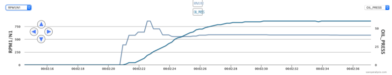

a bit of data
I recently installed the K&P stainless steel cleanable filter in my io-360 and wanted to see how long it took to get the oil pressure up to the minimum idle pressure, about 25psi.
Here's my graph - this is a newly installed filter, and 6 liters of 15w50 with an engine pre-heated from OAT of 4c to about 10c.
I hit 25psi at about 3 seconds after starting. The Lycoming operations guide says to stop running the engine if you don't get oil pressure for 30 seconds.
It seems ok to me, but happy to get other opinions.

I think Bill Lane (BillL on VAF) has some pretty good data on oil pressure rise on his RV-7.
One of the purported benefits of the K&P/Challenger oil filters is the lower internal resistance of the stainless steel mesh versus the standard paper filters. Additionally, there is no anti-drainback valve in the K&P, so the end result should be faster filling of the filter canister and faster oil pressure rise. Of course, this assumes that the filter is mounted cover plate down, so it empties after shutdown. A standard filter empties too, just much slower than the K&P.
The faster rise is one reason I installed a K&P on our RV-7A with an angled oil filter adapter. I was concerned about the delay in oil pressure rise with a standard filter after a prolonged shutdown. Our RV-10 will also have a K&P, but it is mounted vertically with the cover plate up on the firewall - so it shouldn't empty at all after shutdown.
Thanks Krea. I was a bit concerned about the lack of anti-drainback, since I have the angled filter adapter. One positive with the K&P - it makes changing the filter much cleaner - I don't need the ziplock bag any more, just a small rag.
I was surprised at how quickly the oil pressure came up after the oil change, and perhaps it's due to the lower internal resistance as you mentioned. Two subsequent starts were both under 3 seconds to get to 25+ PSI, so it seems consistent.
