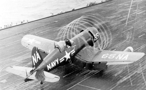

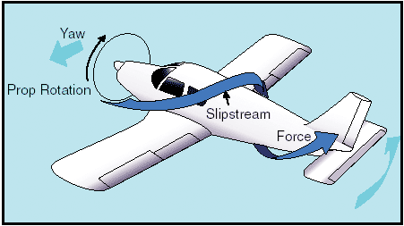

Steve is a sailplane pilot and by definition is very familiar with yaw strings. Yaw strings are used on virtually all sailplanes, and once in awhile you'll see one on a jet. But because of the propeller slipstream, they won't accurately work on tractor prop planes.
To coordinate, "Step on the ball, step away from the string!"
great picture of the F4U. Helmholtz would be proud. Relates tangentially to my thesis.
The mental trick I learned early with yaw stings was to pretend that the tail of the string was connected to your toes. So, you step to pull the tail of the string straight. I learned 'step on the ball' a handful of years later. :)
Wouldn't a yaw string work on a wing, outside the prop slipsteam? Just place a reference mark for coordinated flight.
