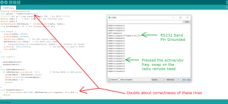

Update: A couple issues solved- main one being that the order that power is applied to which device appears to have a significant effect on the conversion chip performance(I will buy some with a different breakout board). Now I am seeing +8/-8V on the RS-232 when the transmit pin is grounded.
This makes me believe that the final issue is that whatever is being transmitted, is not understood by the radio head. In other words,
I think the problem is with the line of code below (which may contain some rookie mistakes)
RS232serial.write("$PMMRC00G4N29\r\n");
I tried RS232serial.print, also adding ,DEC, HEX, BIN, OCT. Also tried declaring it as a byte, String, char, and placing the variable in the command instead.
<CR> in string is wrong, should be \r\n
Or could remove it and do this before your write delay:
serial.write(13);
serial.write(10);
chksum appears to be incorrect.
Thanks- I corrected <cr>
FWIW this code also sends *something* to the RS232 (according to the oscilloscope), but the expected frequency change is not occuring:
(RS232serial.write(uplink),13);delay(100);
