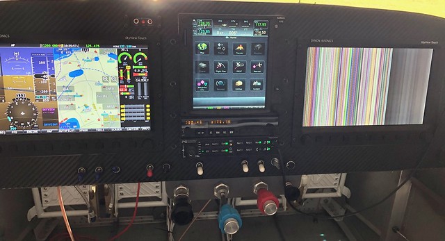

I am finally returning to my build to finish it and while updating latest Skyview files, my copilot display won't boot up. Anyone get just vertical lines on screen when powering up? Have a call into Dynon. Thinking its gonna be a return issue.
Yes, I have, as well as others. See my two posts ("RV8JD" #6 & #7) in the "Colored vertical stripes" thread on the Dynon Forum:
https://forum.flydynon.com/threads/colored-vertical-stripes.11428/#post-68183
You'll have to send it in to be fixed.
That looks suspiciously like a ribbon wire failure or connector failure between the computer and the screen, if it was on a laptop computer. The hinging effect on a laptop screen is rough on flexing the ribbon wire and connectors.
