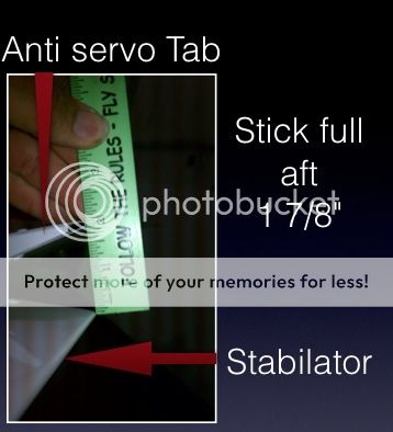

The trim takeoff position is about 1/3 up from the bottom. On the first test flight, it is better to error on the nose-down side. At least one RV-12 crashed on the first flight because of too much nose up trim. The plane leaped into the air and stalled before the startled pilot could react.
Joe Gores
Takeoff Trim Postion
Here is a pic of where to set your trim for takeoff. Adjust your trim to this position then set your Skyview accordingly. ;)

John, Jetguy - I don't understand your picture and accompanying statement. Are you saying you want the stick full aft for take-off???
I don't think so - I tried that with Mike Seager and we both had an "interesting" take-off. Rugged airplane that RV-12!
Bob Bogash
N737G

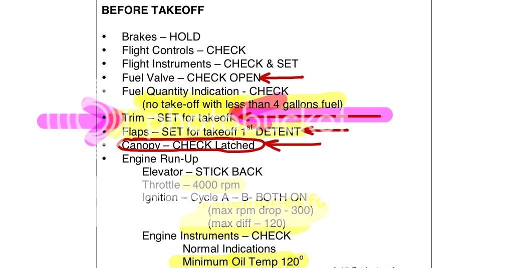

Is this better?
Bob the picture depicts where you want to set the trim for takeoff and how to do it. While in your hanger with the stick full aft
adjust your trim as shown in the Picture. Then as shown on page 7-48 of the Skyview installation manual use the onscreen
wizard to calibrate your trim, then put a small green line on the trim indicator to show you where this takeoff postion is. My picture tells you how to adjust your trim to locate this "Takeoff position" to make the mark on your trim indicator screen.:rolleyes:
As per the POH shown below you need to set your trim to the Takeoff position.
This next picture is for explanation only and is not a true representation of where your Takeoff position might be.
Now note the green line on the indicator, this would indicate where to set your trim for takeoff.;)
Anti-servo tab setting
I've set the tab per your picture - I need to cogitate on the rest.
Thanks for the hand-holding - might need a few more sessions....
