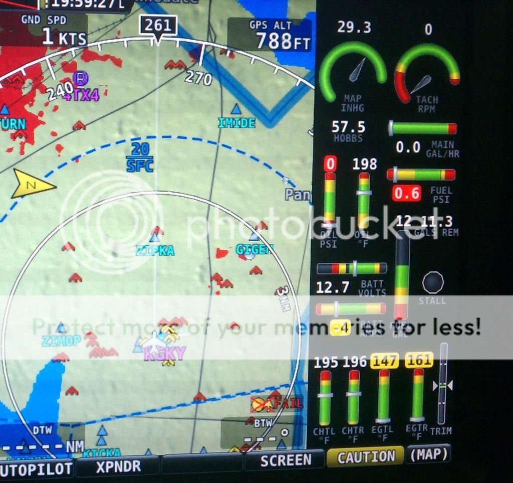

Do you SLSA guys have the Fuel Totalizer shown on you Skyview to the right of your Fuel Quantity indicator as shown in this picture below? If not you can remove the Wing Pin indicator and replace it also as seen in this picture to. That way you can see your fuel start to decrease from full if you want.;)
I can't speak for the Skyview, but my D-180 starts over on the totalizer each engine start. I don't manually enter anything.
