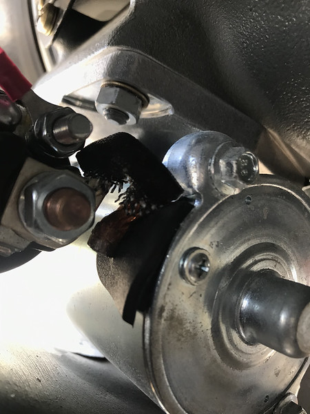

Failure Report:Starter Solenoid
IO-360-M1B
Hours: 196 (but originated at ~40 hrs)
Issue Description: click-no-start
Root cause: Failed solder joint
Discussion: In course of diagnosis, I touched the terminal and the condition was temporally solved. Closer inspection found that the contact post plate had a slight looseness. The solenoid was checked with an ohm meter and the wiggle produced a wide variance in resistance.
Action: Replaced solenoid with "Standard" brand, a Borg Warner (BWD) part was not available on short notice but using the part number found this part for the Crown Vic. SkyTec site had torque specs, and used red loctite on the allen screws.
Pilot/builder: Super happy.
Note: 10mm box end, and a 5mm allen socket driver required for this job.
EDIT: Allow this extra comment - - The SkyTEC manual (downloadable) has a good diagnostic procedure up to a point. In my case, using an ohm meter from ground to this start trigger terminal allowed a wiggle and caused the resistance to vary wildly. This confirmed it as the bad part before finding the fractured solder. This test should be added to your diagnostics. It can also be powered directly with 12v if the wire back to the contactor is removed. The starter should not engage the motor but only push out the pinion. This can be done on the plane and post wiggled to see if it is intermittent. As a field repair, I would have attempted to re-solder that joint to get home (if it was one hop) if tools and/or the part was not available. It would have to be a large soldering iron with the mass involved though . . . .
EDIT-2: Solenoid = Standard Motor part # SS-754 ~$25 @ RockAuto. "Standard Motors" is the manufacturer.

This cracked solder joint seems to be a somewhat common failure-mode of these solenoids. I have seen another Skytec fail like this and I had an original one fail on a 2005 Ford Ranger with a crack in the same area I lived with it operating intermittently for a year before I finally replaced it. If the car wouldn't start, I could reach underneath and wiggle the wires and it would typically start after that.

The “Standard Motor Products” SS-754 has a dual function. The motion of the plunger acts on a yoke lever that extends the pinion/sprag to engage flywheel teeth. The end of that plunger stroke actuates an internal high amperage contactor/switch that connects the large 12v input cable to the starter motor power input. These are the two larger lugs on the end of the SS-754.

I have not taken mine apart yet, but the pictures I found online of these starter solenoids show a plastic shaft that I guess plunges forward of the solenoid. You mean to tell me that that little plastic ding-dong is all that physically causes the teeth to move forward and engage with the ring gear?? Is there some illustration of how this mechanism works? Wouldn't that be prone to failure?
So this connector wire is not a ground (as I believed) but carries the starter current from the solenoid to the starter when the solenoid is engaged?
It's nylon -- sometimes it's steel. It moves aft when the solenoid is energized. The nylon catch pulls one end of a pivot arm in (think see-saw), which moves the other end carrying the pinion/sprag gear forward engaging the starter ring gear. Once the plunger has reached its full travel limit, contacts at the back are closed, energizing the starter motor.

3. ~200 hour starter (donated from a friend), fully functional and working when replaced by a different Skytec model.
Long story short...I ended up pulling all 3 apart after finding the internal plastic throw-out fork worn. Here's some photos of the internal guts.
Top photo shows the throw-out fork from starter #2 in the above list (white fork and ring on the right, along with the planetary ring gear which doubles as the top of the electric motor). Also in the photo is the throw-out fork from starter #1 (black throw-out fork and white throw-out ring) on the left side.
The bottom photo shows the throw-out fork assembly from starter #3.
Notice the worn (oversized) holes in the arms from #2 and #3. The debris around the holes (I thought at first it was some type of white grease) turns out to be plastic dust, worn from the ID of the arm hole where the throw-out ring snaps in. Compare these to the new looking parts from starter #1 (black arm, white ring).
Wish I had photos of the complete "exploded" starter assembly, but couldn't find any. So, a brief description of the starter assembly construction. The motor shaft drives 3 metal planetary gears inside a stationary plastic ring gear/motor top cover. This in turn drives the steel output shaft of the starter. The throw-out arm assembly, actuated by the on board starter assembly solenoid slide up and the output shaft so the starter output gear can engage the engine starter ring gear.
The plastic parts from all 3 do appear to be some type of glass filled material. Probably nylon or polycarbonate (my guess....not enough of a plastics engineer to say for sure). You can find similar looking material used on many auto parts, including engine related ones. So, the material isn't surprising. What is surprising is the wear in the throw-out fork holes.
To end my tale of the 3 starters, I did manage to put one working starter together. Ended up using it for about 4 months.....while I waited for delivery of a B&C starter (all metal internals ;) ). Decided I'd take the 1ish pound hit on weight increase.
