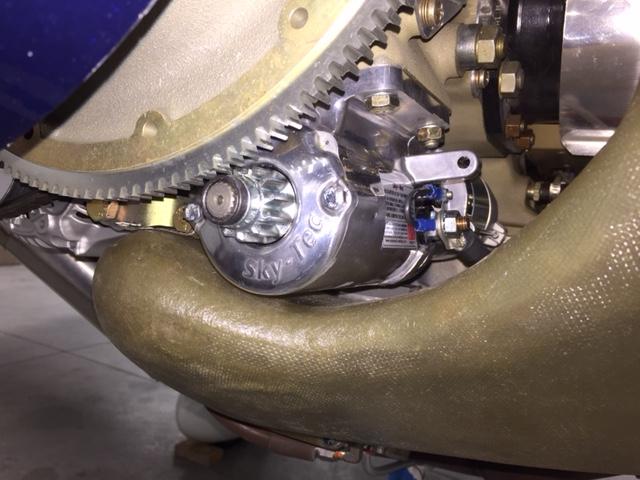

My RV-7, since I have bought it has this "CRANKY" start. Some have called it the BUMP to START, meaning the starter has trouble getting the prop through the first compression stroke. It has never failed to start but it isn't right in my mind that you need to try 3-6 times to get the starter to crank the prop through for the start.
I did the troubleshooting via the SkyTec instructions and even talked to the techs at SkyTec. As they mention, these PERM MAGNET starters need 11 Volts at least to the starter while it is starting and if you can't get 11 Volts to the starter while starting it is JUST NOT GOING TO PERFORM as it should. It didn't matter if it was hot or cold, low battery or right off the charger.
So here are some pics of my Old SkyTec 149-LSX starter mounted on my RV-7 with the O360 Engine.
And here is a video of it trying to start. I think the battery measured 12.4 Volts prior to this attempt:
https://youtu.be/R3URjpaJyfU
So in talking with SkyTec on the phone and also at Oshkosh they said that they will take my 149-LSX and give me a credit towards a new starter like the 149-NL. So I did the online RMA and had them send me the 149-NL. After taking the above video, I immediately removed the 149-LSX and mounted the 149-NL.

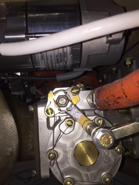

Here are some pics of the new SkyTec 149-NL started mounted on my RV-7 with the O360 Engine.
Note: I will put a rub bushing over the B+ lead going to the starter so it doesn't rub on the back housing.
And here is a video of it STARTING! Notice I left out the word "trying". This starter really spins the prop like it should be spun!
https://www.youtube.com/watch?v=4pTj-Gsibqg
I would recommend if you have the 149-LSX and are having the BUMP to START Blues to order the 149-NL and you won't be sorry. Off the top of my head the price was $599 for new starter, less $305 credit for the 149-LSX plus some shipping both directions.

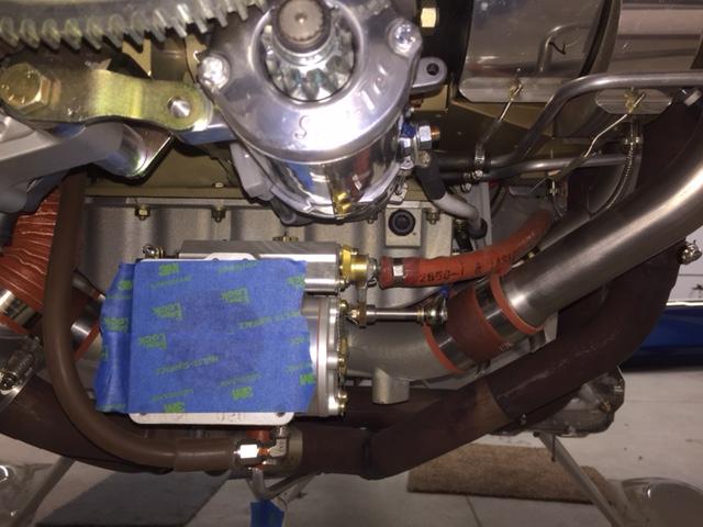

I have the same starting issues using the 149-12LS starter.......can't get past the first compression stroke and takes 3 or 4 tries to get it to turn over. My hanger neighbor who is an A&P/IA came and put a bunch of gauges on the starting circuit. With my resting battery showing 12.6 volts, when attempting to start the voltage at the battery dropped to 5.83 volts and at the starter the voltage was 2.5. The amperage was 458 amps whereas it should be around 200 amps. The mechanic said these readings indicated an almost dead short. All connections were checked with no looseness, corrosion, or lack of continuity. His conclusion was that the starter simply wasn't powerful enough (not enough torque) to turn over the engine.
I sent the starter back to SkyTec. They checked it out and said nothing was wrong with the starter, but suggested I upgrade to the NL model, which I did. When it arrived and I tried to install it I found that it would not fit. Because the solenoid is mounted in the back of the starter motor, instead of along side, the starter was longer and interfered with the F.I. throttle linkage. I have the horizontal fuel injection system sometimes called the "snorkel" system. There was no practical way to install the NL starter. I'm back to the 149-12LS model and hate it!

I think I have the same setup on my RV-8 as you. I'm using the SkyTec 149-LS and it starts like the video earlier in this thread, poorly if at all. I have a Bendix FI with snorkel. The linkage on the Bendix is as you described. I'm certain it would interfere with the longer SkyTec 149-NL starter.
Unfortunately, my linkage doesn't look like what "Redrock" is showing in post #13. Specifically:
[/QUOTE]
Can anyone tell me if a Bendix FI linkage be setup like the photo above?

Had the same problem it seems. Using a off set mixture arm and following the manual to remove the unused tangs from the stater made it fit just fine. Larry
