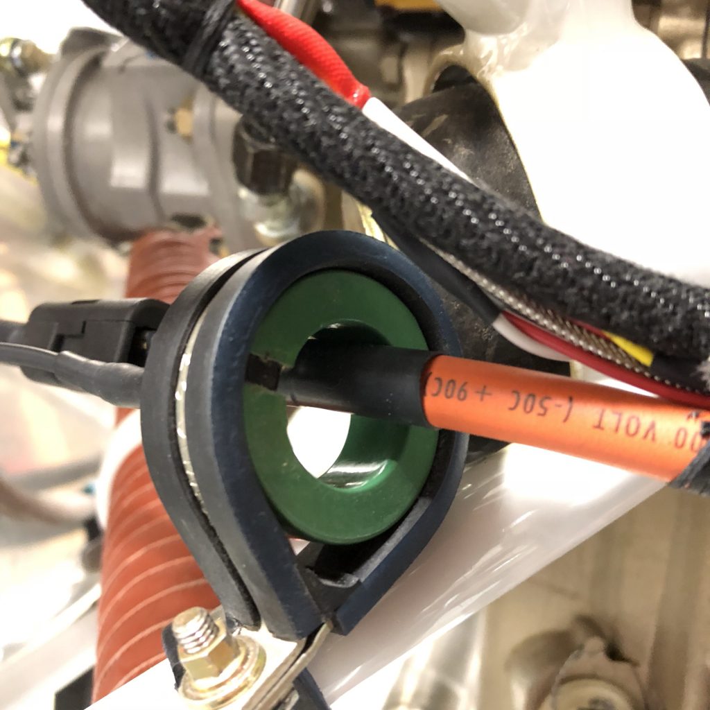

Hall effect
Heres a link to the Amploc key 100 which is specifically mentioned in the Garmin G3x manual. At $25 each, I might just buy two and monitor both the Alt and the battery. Can someone who has installed one please post a pic of how they did it?
Another interesting issue is the location of the shunt. For example, Garmin specifically say on the battery line to install in between the positive terminal and the battery contactor. Meanwhile Dynon, specifically says after the contactor. :confused: I guess install as recommended by whatever mfr you are using.

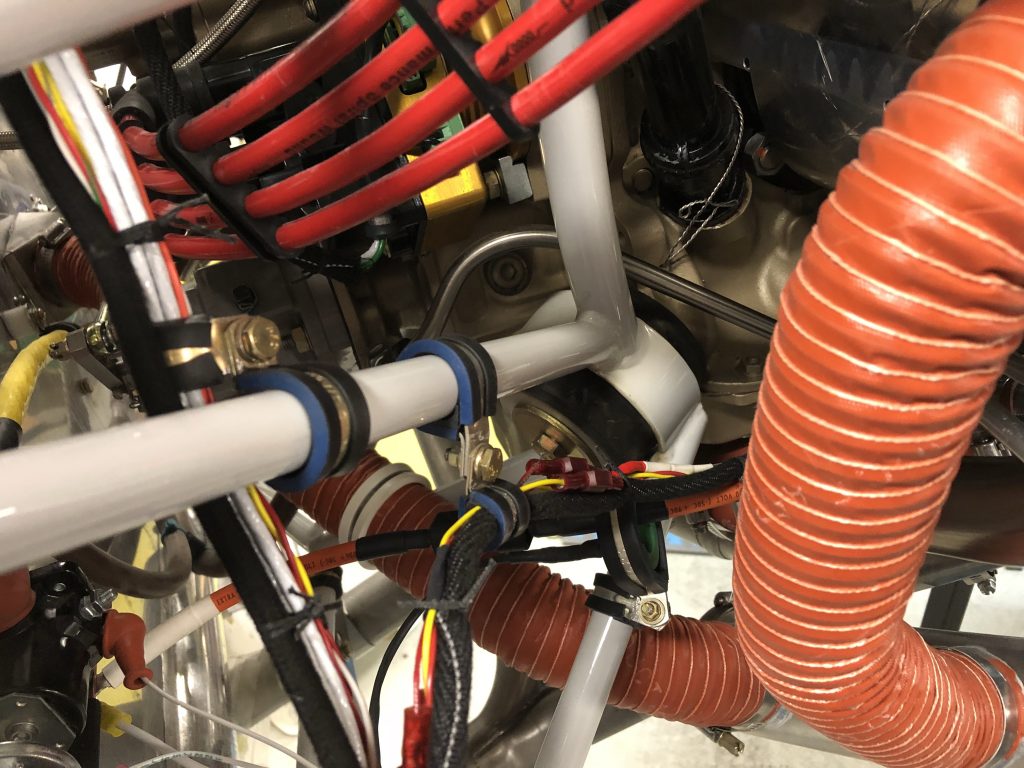

Any chance of posting a pic of your install?
Sure - here are a couple.
Please keep in mind that I'm not flying, so this installation may not be a good one. I know it functions, but will it last 2000 hours? Not yet sure.
