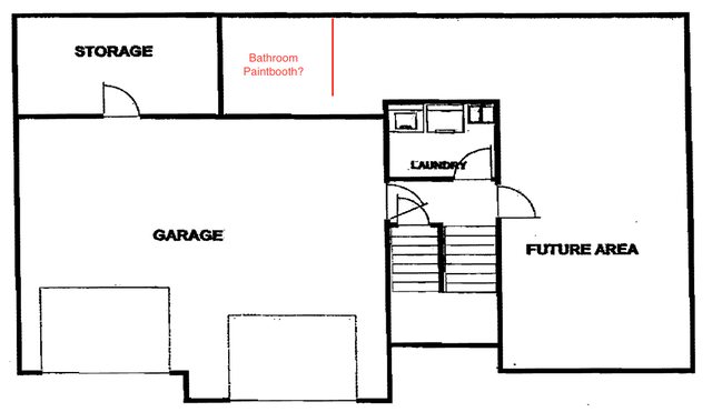

Here is a diagram of the lower level:
I have marked out on that diagram, in red, where the bathroom area is laid out. I have stubbed in the pluming and studded the walls. But, it its not finished. The part marked "Future Area" is the area where I am building the plane, and my wifes workout space. My plans were to go ahead and finish the bathroom so I would have one for my build sessions, but now I am considering using that area as a temporary paint booth.

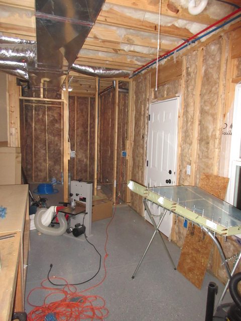

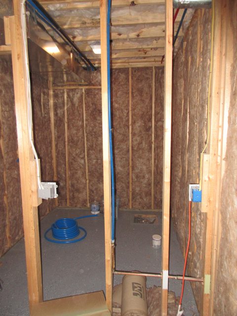

Here's some photos of the area to get an idea:
And a bit closer in:
![jhtFS24l.jpg](/community/proxy.php?image=http%3A%2F%2Fimgur.com%2FjhtFS24l.jpg&hash=46ede4cced627d707455568ceeac8de7)
![2uxO81il.jpg](/community/proxy.php?image=http%3A%2F%2Fimgur.com%2F2uxO81il.jpg&hash=b917a0ca35de5bf4d4efbd2a47c01ea7)
![GQ3u6eYl.jpg](/community/proxy.php?image=http%3A%2F%2Fimgur.com%2FGQ3u6eYl.jpg&hash=6edd4aa119a2ead06854f64309888e40)
