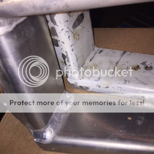

I posted a photo of my nose wheel fork failure on 4/26/16 on the Nose Wheel Crack thread started by Andre Mendonca. The welds on the nose forks are significantly different. The weld bead on the replacement nose fork is much wider with a larger heat affected area radiating out from the edge of the weld indicating good weld penetration.

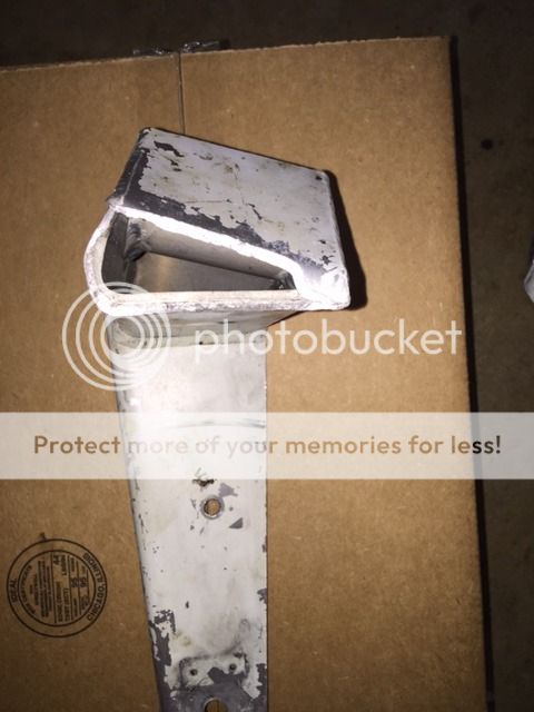

The original nose fork fractured completely as I was removing the tire. This cross section shows that there is no penetration in most of the weld. There is a pretty little fillet weld sitting on top of the ?joined? pieces of metal to quote my structures guru.

Bigger weld bead doesn't necessarily mean deeper penetration...... .........
As posted in a previous thread about the nose fork, supplemental testing was done on the nose fork at the request of the FAA after a botched landing accident.
A number of different forks were tested (big weld bead, small weld bead, etc.) and all failed under static load at very near the same load value, and well beyond the required load. The FAA was fully satisfied with the results of the testing.
This thread is about cracks that begin at the edge of the fork web, that if allowed to propagate, will likely result in the nose fork disassembling itself.
