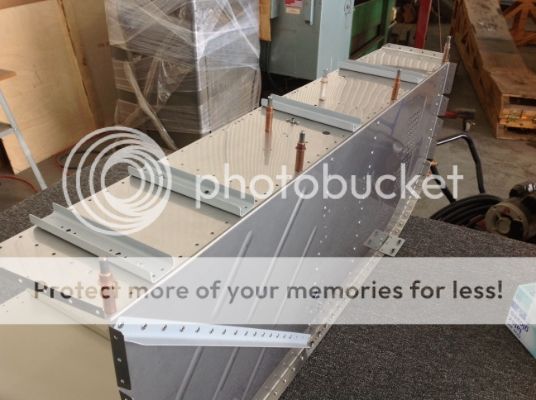

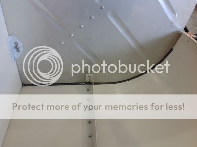

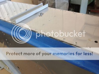

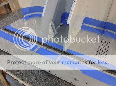

Ready to seal the firewall lower and shelf sections with the Flamemaster CS-3204 B2 sealant. From reading through many (too many?) posts on the subject, I still haven't satisfied myself that I know what I need to. Any help will be appreciated.
I intend to apply the sealant, cleco 100%, then come back and rivet when the sealant is partially but not fully cured. Does anyone have a reason why it can't or shouldn't be done like that?
What kind of cure times can I expect with ambient temps ranging from mid 70s to high 40s, day to night? I haven't found any cure time data for this product. Is there a chart somewhere?
