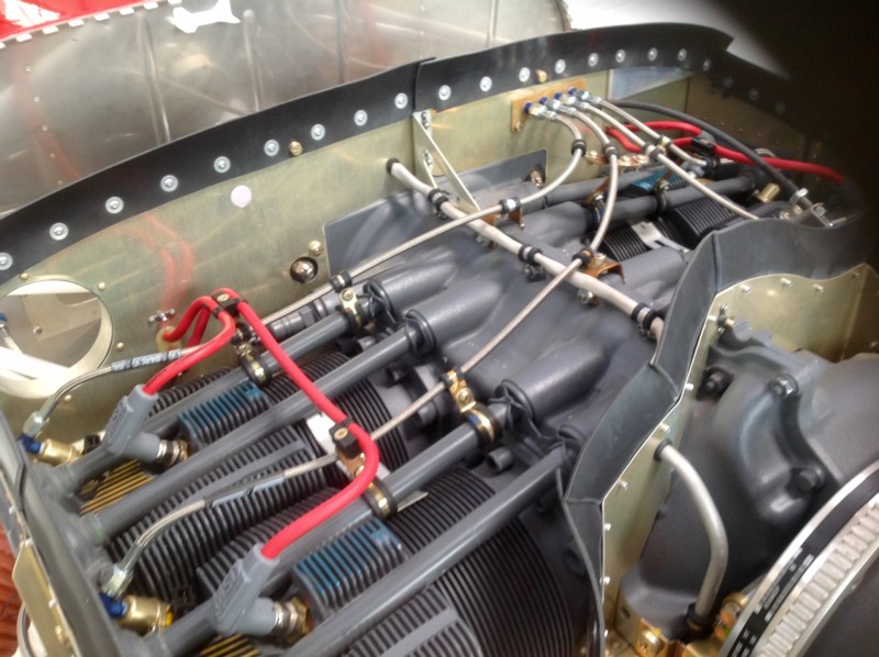

1st Solo Flight N30BY - RV10 with SDS
Took first solo flight with RV10 (N30BY) with SDS dual ignition\fuel injection this week.
Engine was built by Continental (Titan ) stock IO540 D4A5. They built up the engine and tested with slave Magnetos\Fuel injection, performed 3 hour test run, stripped off Mag\Fuel injection system and shipped the engine to me.
Looking forward to exploring all the capabilities of this SDS system.
Thx to Barry & SDS for all the great support in getting this done.

This is a really clean installation, pretty sure I will be copying most of it.
That's Marvin McGraw's RV-14. We share lots of his installation photos with customers on how to do a clean installation. He does super nice work!
Wish I had known about the through the baffle setup for the injector lines----looks like a cleaner setup than what I have. Three less lines on top of the engine.
Got any close up shots of the bracket holding the injector lines and the ignition wires? Looks like a slice of alum angle sandwiched between the Adel clamps.
Hello Mike,
When you get the fuel block from SDS it includes a drill template. I just opened up four of the holes to accept the -AN3 hardware. I then used the drill template as a doubler. That is what you see on the frontside of the baffle.
The fuel line and spark plug holder brackets are aluminum scrap I cut to fit and adel clamps. I was worried that steel brackets may be required; however, none of the aluminum brackets have cracked and I?m at 400+ hours. The plastic spark plug wire holders were purchased at www.Jegs.com and bolted to aluminum brackets.
Thanks Marvin, appreciate you posting a response.
I already have the fuel distribution block that is mounted to the top case split, and all lines in place. That puts the fuel supply, fuel return, and fuel pressure lines inside the baffling.
I just think your setup is a lot cleaner------basically jealous I am.
